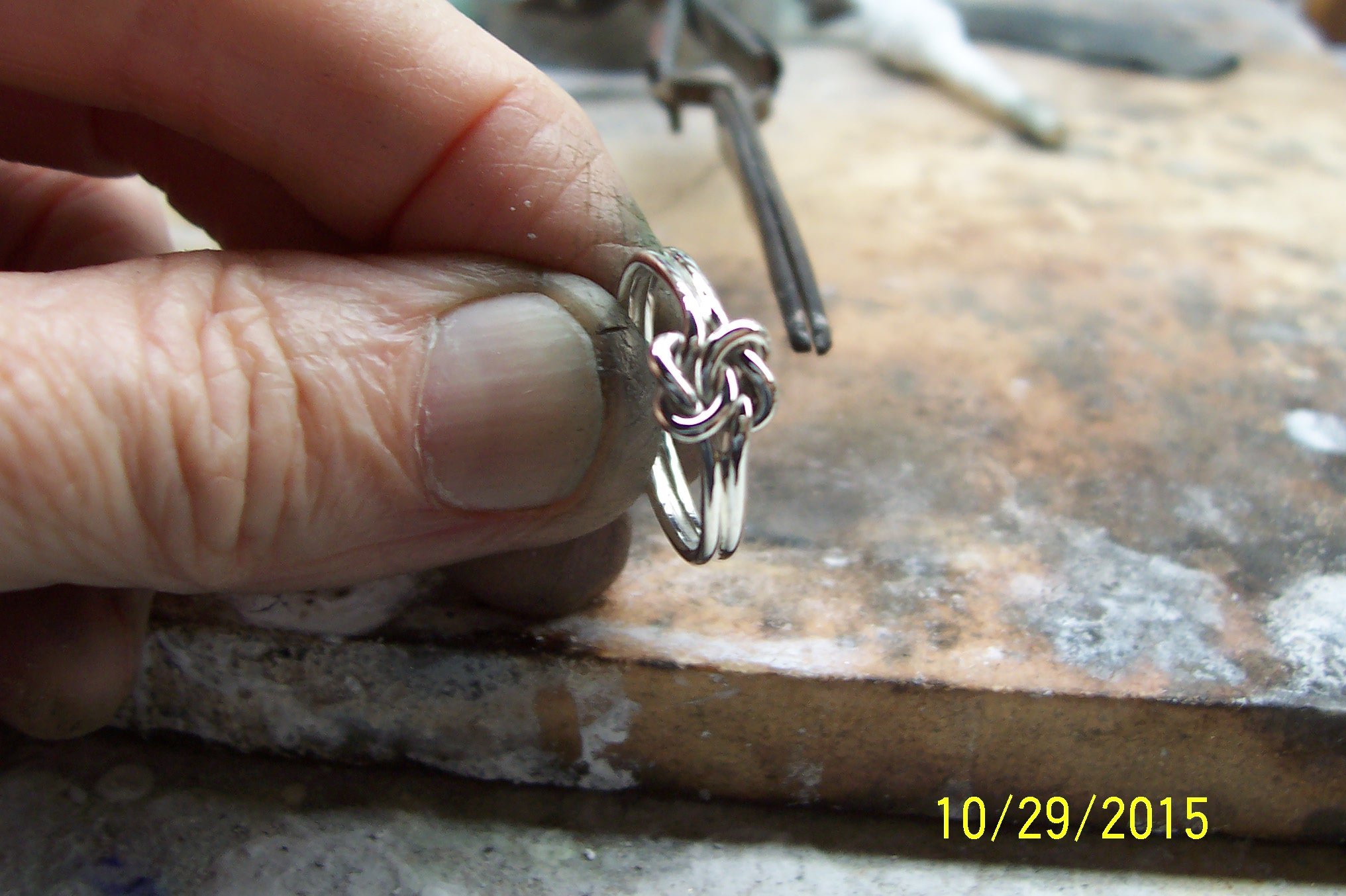

[Project] How I made a double knot ring
I annealed the wire three times at various stages in order to pull
the knots smaller and smaller.
The following photos will show the process.
http://www.ganoksin.com/gnkurl/ep822r [PDF file]
Simple and fun project.

Thanks so much for the photo sequence, and of course the ring. Could
you explain the set-up for the pickling after soldering the ring
shut? I don’t recognize the material holding the ring in the pickle
(assuming that is pickle. Could it be an ultrasonic?)
Could you explain the set-up for the pickling after soldering the
ring shut? I don’t recognize the material holding the ring in the
pickle (assuming that is pickle. Could it be an ultrasonic.
Noralie, You are right, the photo is of a pickle pot. I cut a slit
out of the top of it for easy access and it still keeps the liquid
from evaporating fairly well. I suspend my rings on a plastic coat
hanger I have formed into a u-shape. You can easily bend a plastic
coat hanger into shape by gently heating it with your torch. Good
question.
