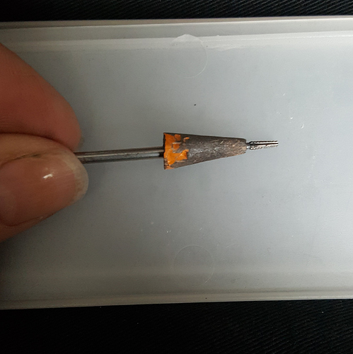

To gain better control of burs for precision work, you need to hold the handpiece of your Flexshaft like a pencil, with your pointer finger and thumb. Then place your middle finger on the shaft of the bur. The ring finger and pinkie should be on the work or the bench-pin to stabilize your hand.
The idea of touching a spinning bur is scary, but you can cutoff a regular pencil to the length of the shaft of the bur that is exposed when the bur is in the chuck head of the handpiece. Then drill the graphite from the center using a drill bit the diameter as the shaft of the bur. Place the shaft of the bur in the pencil before putting the bur in the handpiece. You now have a collar on the bur shaft to place your finger for better control and precision use of the bur.
This is an upcoming tip on Instagram @FSGmetal, and in the FSGmetal.org newsletter. Both are open to the public, and we would love to have you share your tips and tools!
