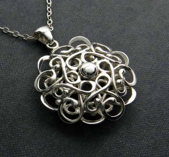

Hi Orchid, i’m having a small issue with porosity in my granules.I am
doing a lot of work lately with fusing fairly large argentium
granules (like 4-6mm or so) as the center of my filligree mandala
pieces. I make them by melting clean scrap on a charcoal block with a
propane torch. I still use a cheap bernzomatic plumbers torch for all
my work, it’s what I learned with and I like it… anyway sometimes
my granules have some porosity that doesn’t show up until final
polishing, requiring me to go back and burnish and rebuff it. Does
anyone know of a way to reduce porosity when melting granules on a
charcoal block? Here’s a link to one of my 3d filligree pieces on
etsy:
Thanks, Douglas

Hi Peter, I was using flux for a while but I stopped when I noticed
that the molten flux would become a little puddle on the surface of
the metal and leave a small round depression in the granule after
pickling. For my purposes I usually need granules that are flat on
the bottom so I letthem cool on the charcoal block rather than
dropping them into water. Perhaps that may be the reason why flux
leaves a mark on the surface? here’s a link to one of my pieces that
I did with 22K granulation. htt=shop_home_active Thanks again,
Douglas
