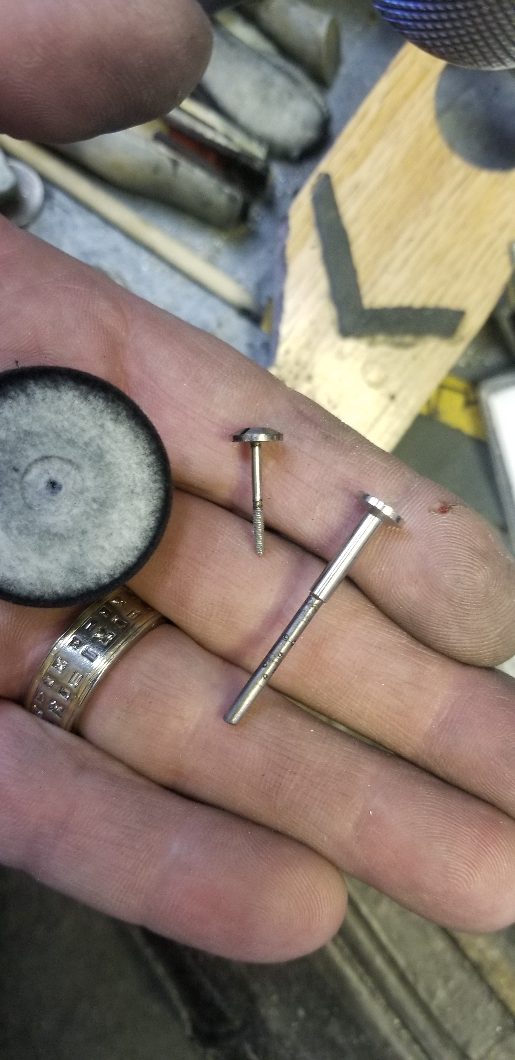

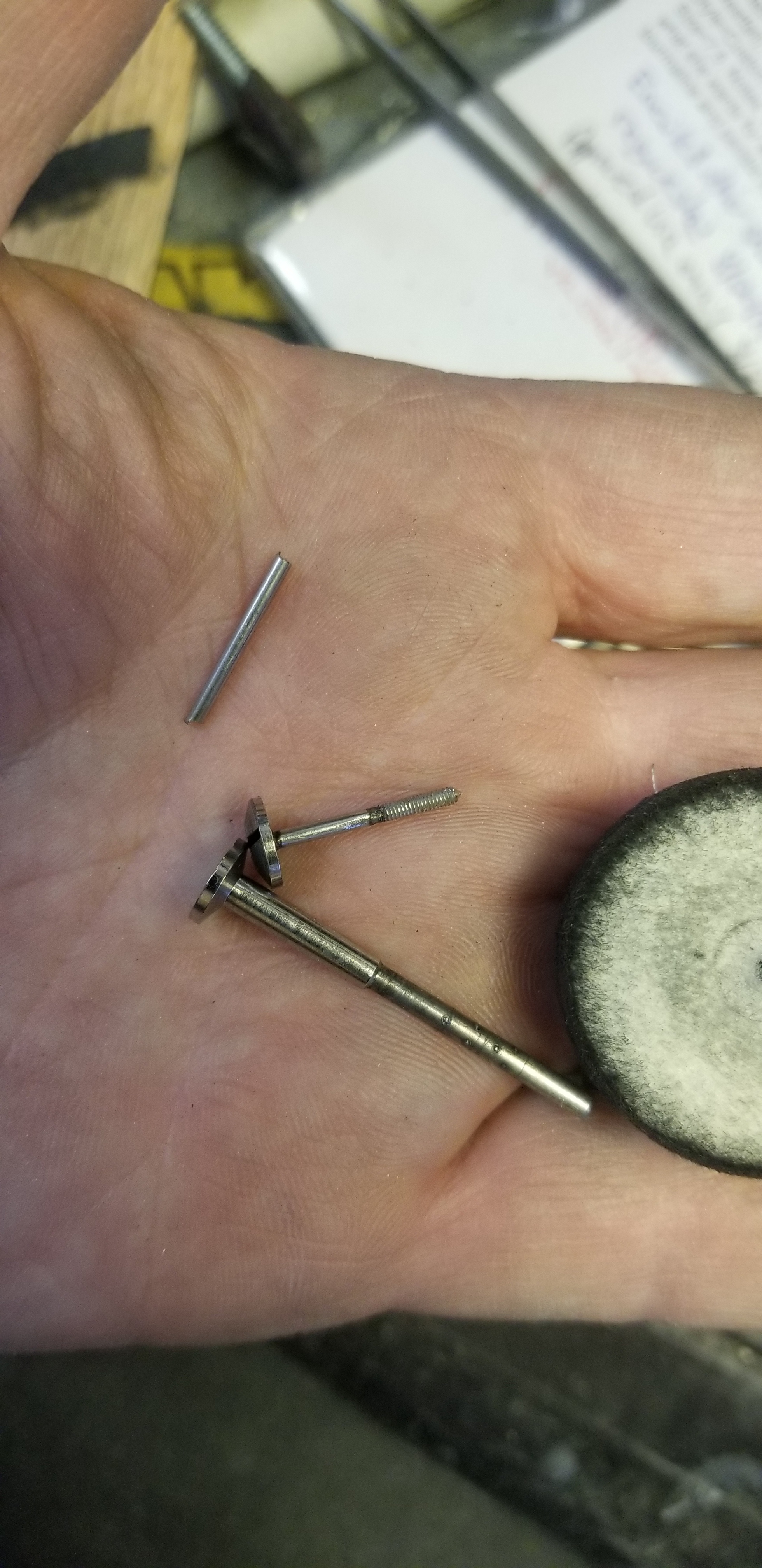

I extended the screw with stainless welding rod ( which is great for tons of stuff) this is the thinner filler rod. Small piece shown.
Get it as straight as you can
Looks like a Brad nail might work good too.
