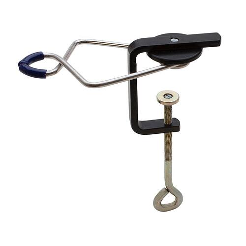

Otto Frei does sell a disposable fuel tank holder. I’ve been meaning to buy one for a while! Seems like a good, inexpensive solution.
Glad you figured out what the problem was and how to fix it!
