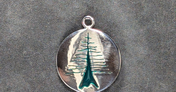

This is my first real durenamel project. The pendant is a two piece, top pierced and the bottom solid. They are each domed a bit to create a cavity when they are soldered together. After adding the jump ring, I pushed green durenamel into the cavity with a syringe. I over filled a bit. Once it cured, the overflow was easy to remove with a fine abrasive wheel and then light polish…Rob

The colour looks fabulous, Rob
