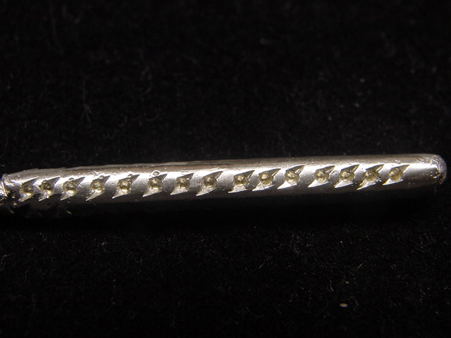

You will see how easy it is in using a simple Onglette #1 & #2
graver. I use the #1 graver to just cut the ‘rough out-line’. Then I
enhance the cutting with my favourite #2 graver.

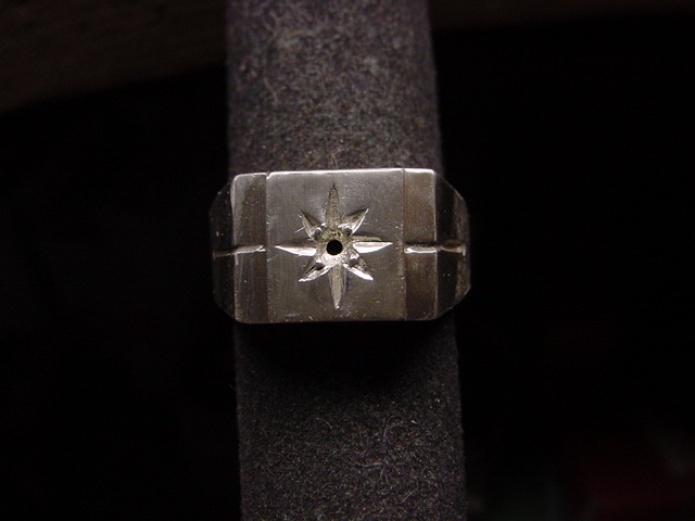

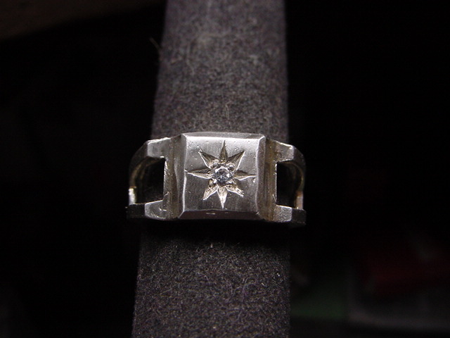

You can see I never use any measuring device to cut out a pattern.
Even in the “Star Setting”, this one pattern took me about 25
minutes. Again, I did all of the cutting prior to the setting of the
stone.

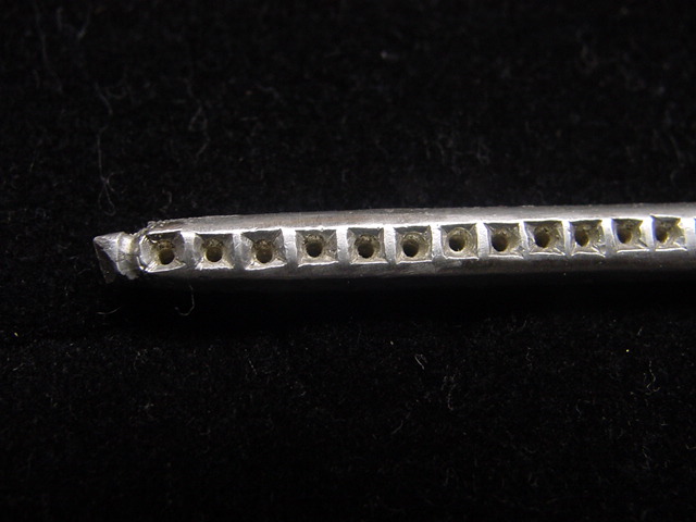

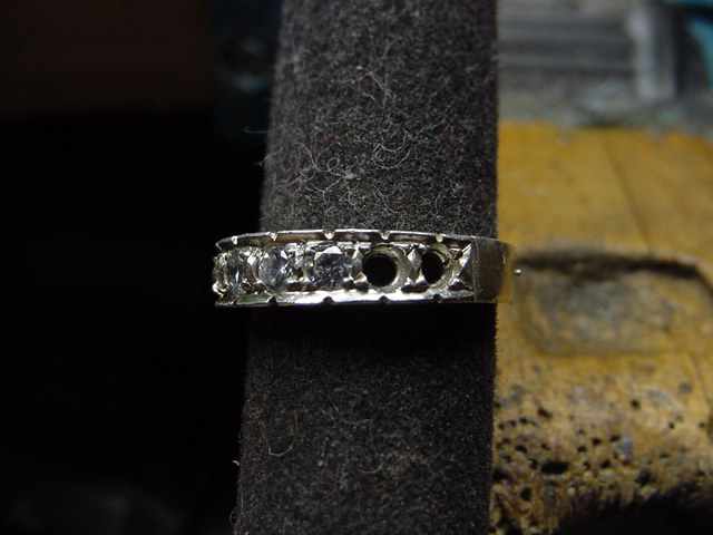

The ring with some stones in it, is called “Pre-Cutting”, as the
graver does all of the cutting prior to the setting of the stone. If
the stones were in the silver first, I’d be hitting all of the
girdles & it’d look like (you supply the letters)! Those patterns on
the silver rod are called “Azure”. Underneath each stone setting
hole is this pattern. Imagine the jeweller cutting those patterns
with a #6/0 saw blade or even the much talked about #10/0. But I
prefer the graver cutting best, this is my preference. But the
