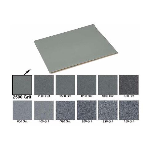

Hi,
is this the one you use and like?…grey backing color?
julie
