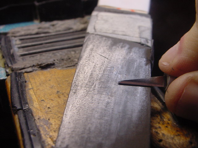

As an additional reply to ‘Monica on polishing papers’ are two photographs
showing just how the graphite pencil rubbing is done. The ‘shine’ being
then produced is just ‘a-awesome’, just like “Hubble Telescope” mirror!
