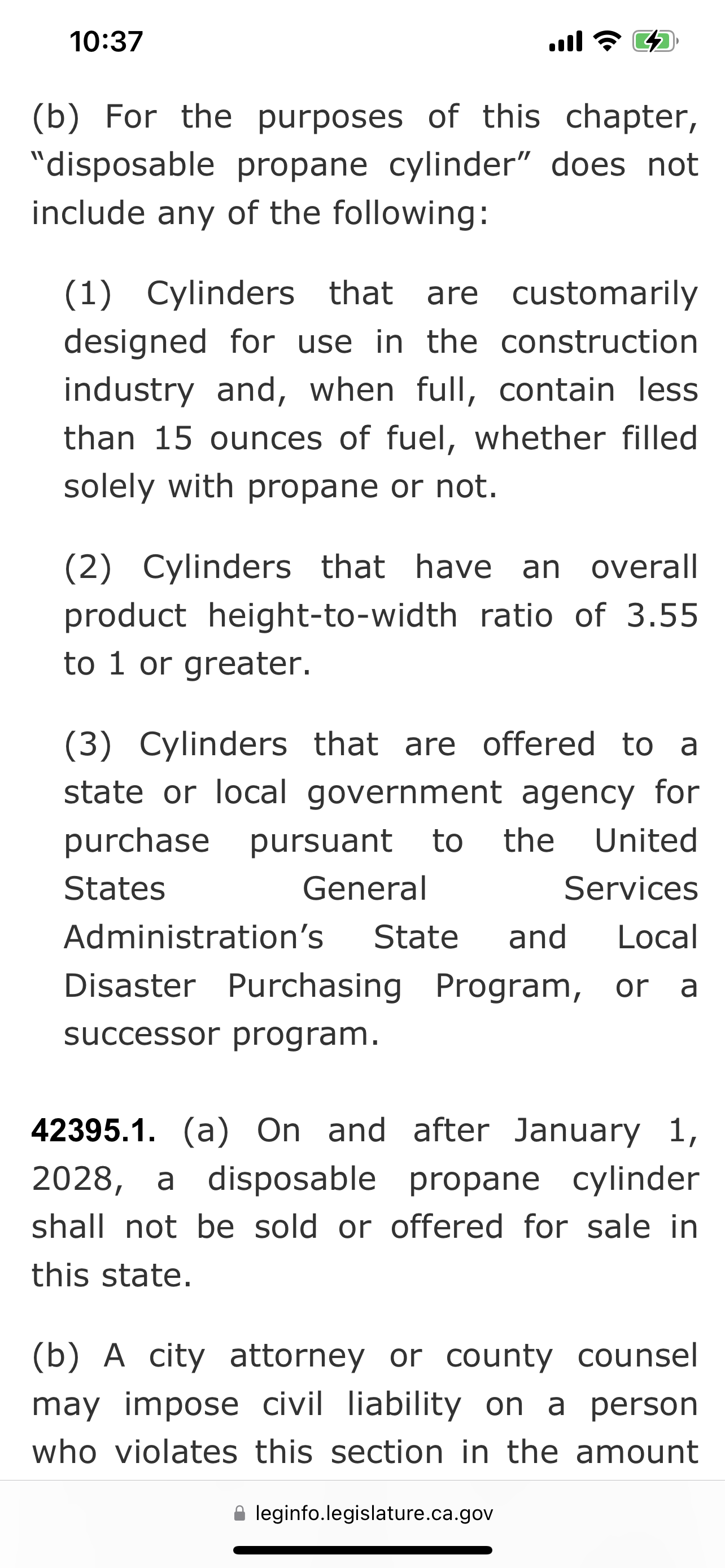

Hi,
i believe california SB1256 banning disposable propane was veto’d…so far…
julie
Thanks Julie. I had read the applicable section of the California Fire Code–apparently on an unreliable website–and came away with the impression that it had passed into law. Given the current green agenda of government, I accepted it and didn’t read further. And I’m a lawyer, admittedly retired, but a lawyer nonetheless.
Hi,
also…interesting…re the original proposed bill…i read (but neglected to save!) an article that described the taller, skinnier disposable 14 oz propane tanks, as falling outside the definition of “disposable propane cylinder”…in that the height to width ratio is outside of the definition…not sure if this is true…if i can find the article i will post it here…
julie
Hi Julie:
Hahaha. The version I saw–and it’s on me that I didn’t catch it–started with 42395.1 (a) as you posted above. I have to look into this to find out the reason for the exception and if it might have any effect on whether I can get away with using a propane torch in my apartment. Thanks for posting it.
Michael
Hi,
also, i read that the ban is on sales…not use…i think…need to
confirm that…
julie
That’s correct, Julie. The proposed ban is strictly limited to sales and offering for sale. Possession is not affected.
Sorry for the double post, but the first post was incomplete. After doing some reading, the proposed ban was intended to address the apparently widespread litter of disposable propane tanks in camping areas, and was expressly limited to sale and offering for sale. Possession was not affected. Since I have been unable to find any mention of water torches being useful for anything other than small pieces, it appears that a propane torch has become my only workable solution.
