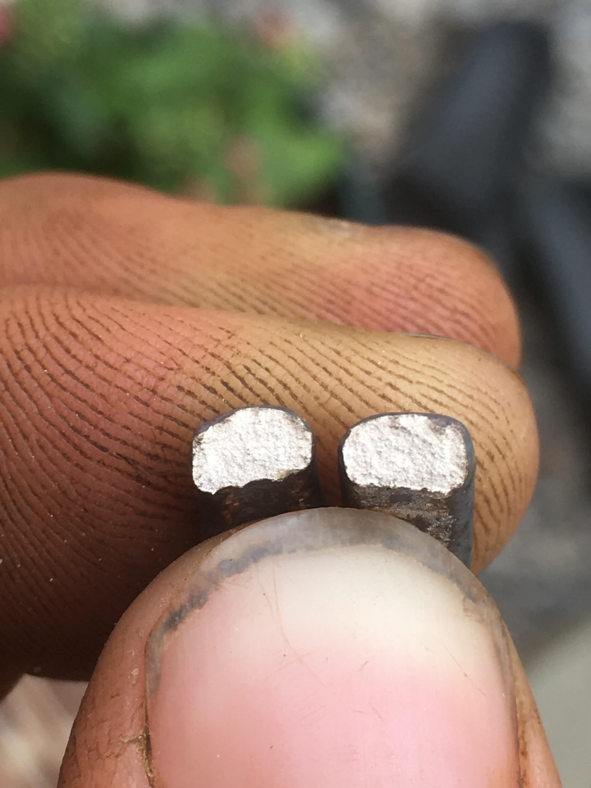

This recent casting is a lot better, a bad pour on my end but better. Brand new alloyed (pure copper and silver) and casted at lower temperature. I snapped it intentionally to see if there were any impurities, none that I could tell. Will keep y’all posted on the rolling
