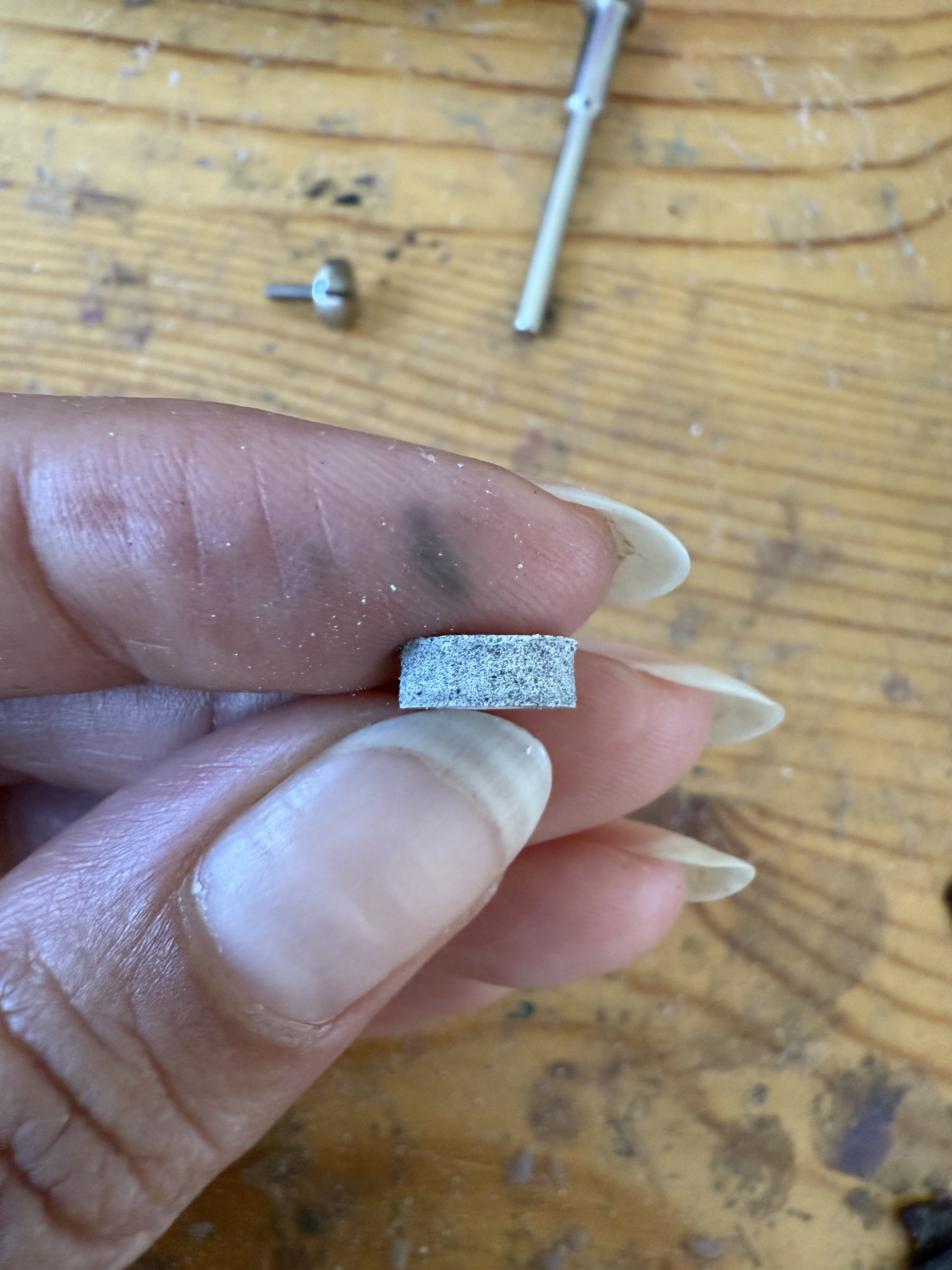

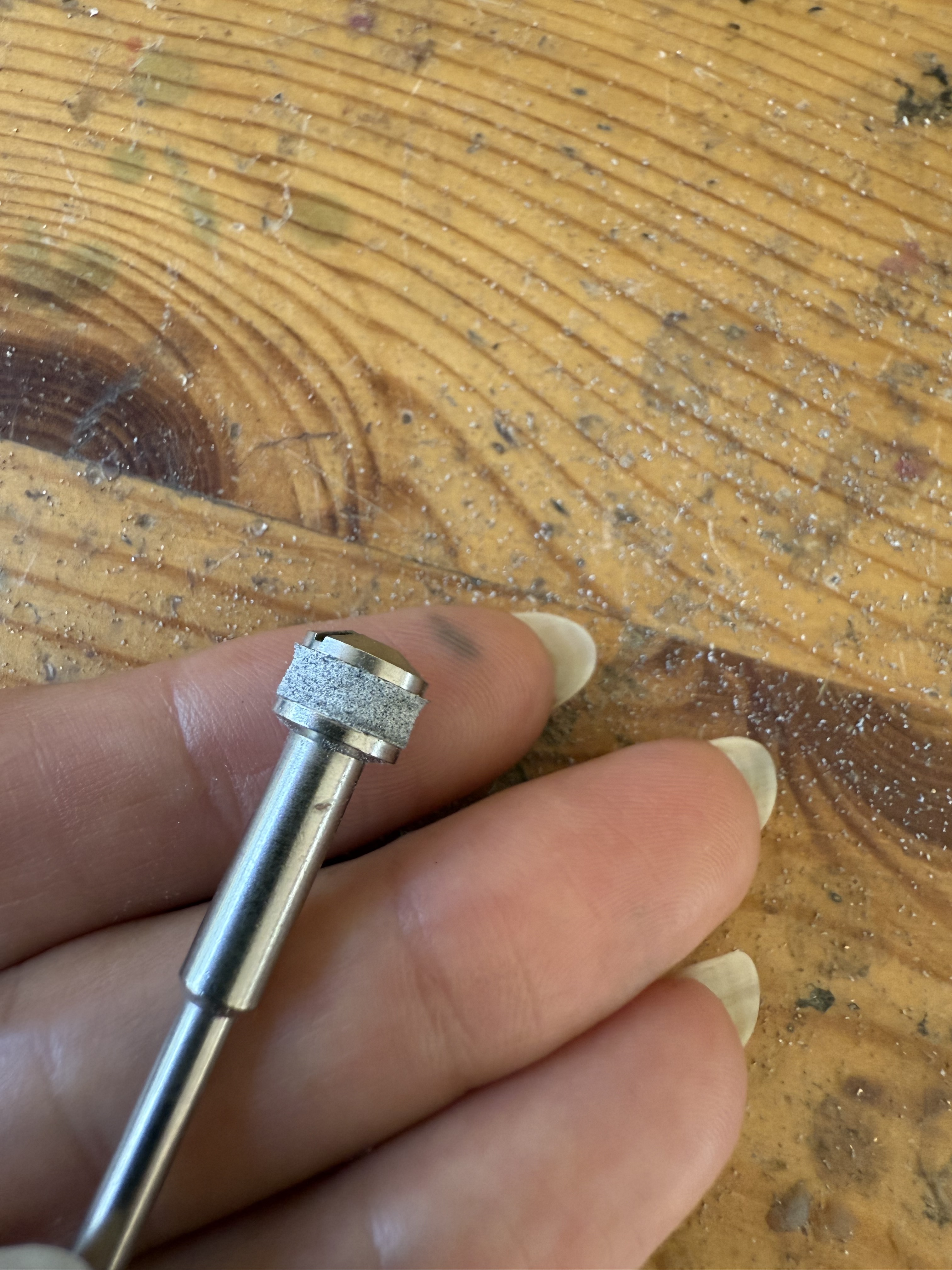

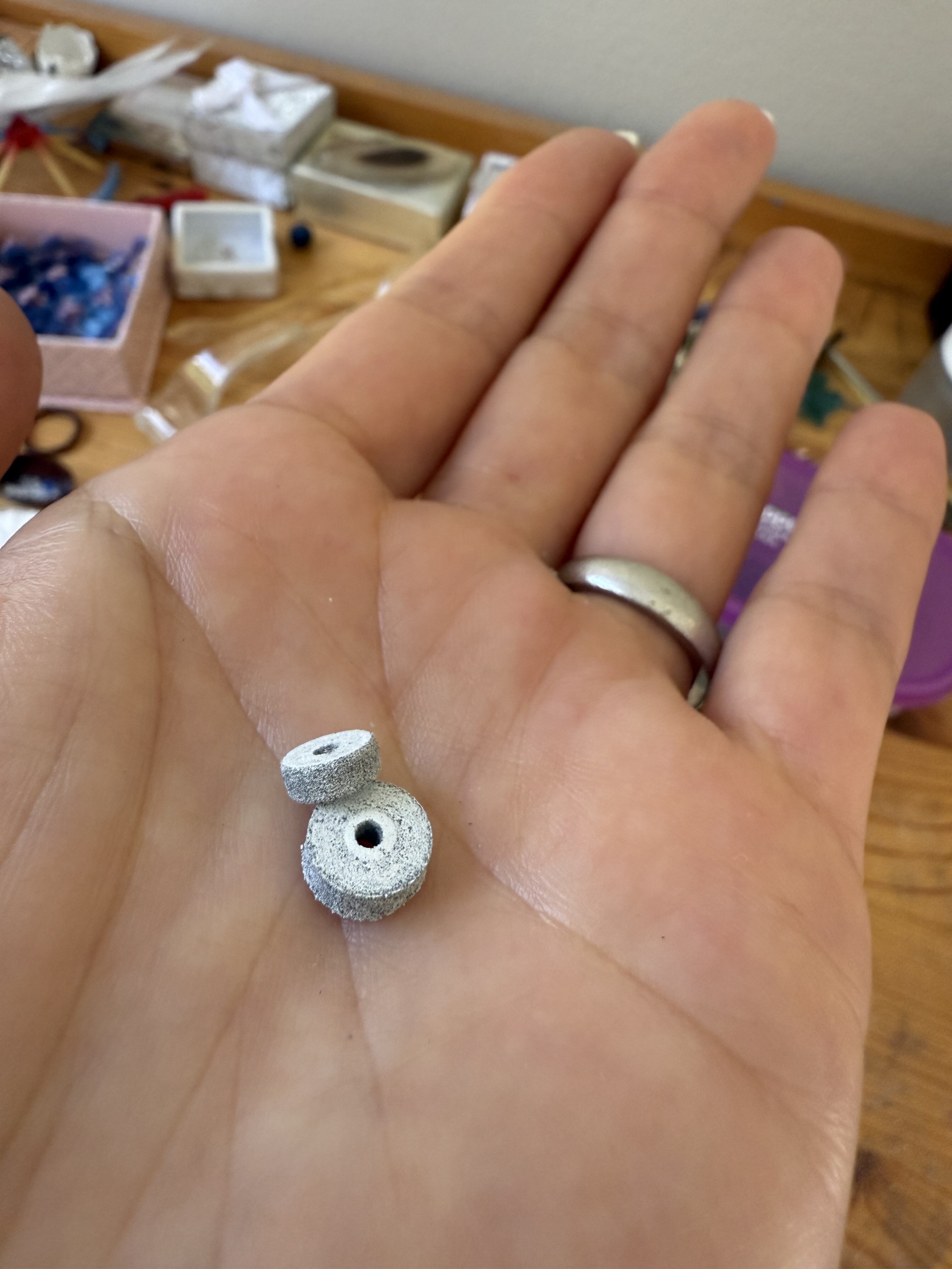

Hi everyone,
I was given these to grind down sprues after casting.
They work great! Only problem is I have no idea what they are called so I’m unsure of what to order.
Any help would be greatly appreciated!
Called “heatless wheels” Also sometimes called mizzy wheels. Come in a couple different diameters.
Thank you :slight_smile:
Looks like a worn down mizzy wheel. They come in different sizes…Rob
