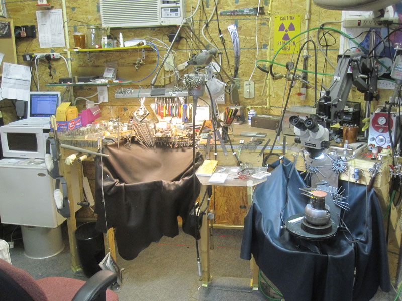

I wanted to add that, having been a bench jeweler for 30 something
years, I’ve dropped quite a few little pieces of metal and melee,
and having a concrete or tile floor under me for most of those years,
decided that I was tired of losing stuff to the trolls who live in
dark places in my shop. The carpet prevents bouncing and I’ve also
tapered the floors up to the walls (like in an ER) and ran the
carpet abit above that, and sealed the top with silicon. Here’s a
picture.
The red lines show where the floor line and the wall line is. I also
installed a florescent light under my desk.
