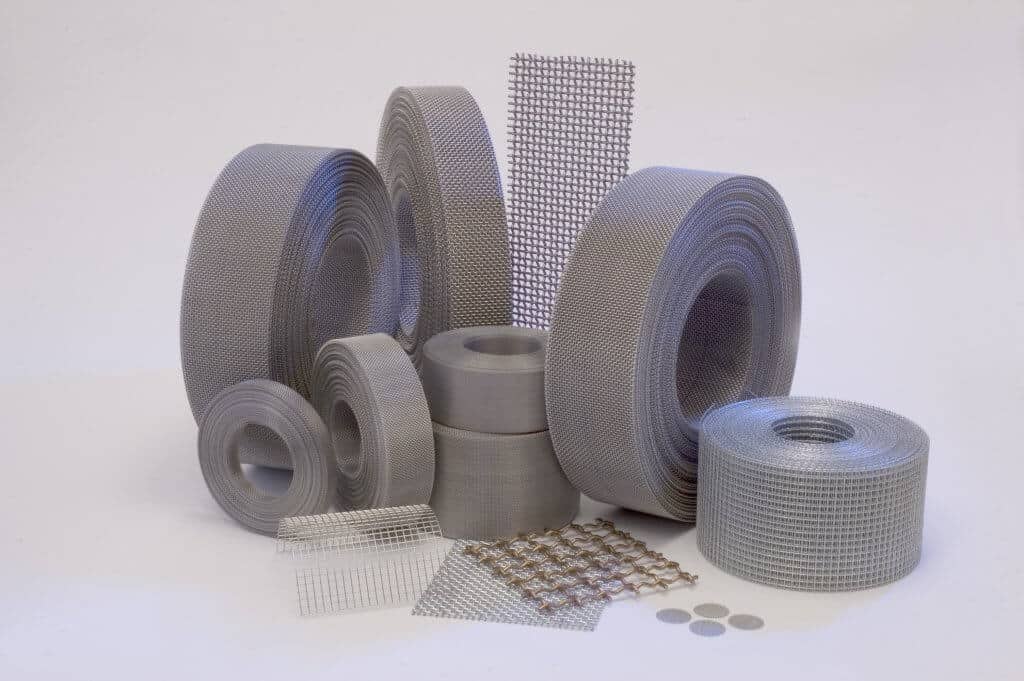

Any good hardware store should have other sizes of hardware cloth.
The heavy soldering screen you're talking about is 4 mesh. [snip]
No need to buy something specifically for soldering.
Actually, hardware cloth is typically galvenized. I’m reasonably
sure that means it’s coated with zinc, making it a poor choice for
soldering, and possibly also for your health.

Thanks to John Donivan for the link below, in response to the quest
for the perfect soldering screen:
I called them and they were very helpful. They could set up to make
10 one-foot square mesh pieces in a stainless alloy heatable to 1800
degrees for roughly $50 each.
I would surely pay that for a great soldering screen, but would need
at least 9 other Orchidians to go in too. I’d be willing to cover the
initial cost and send them out if there is enough interest. Contact
me offline if you’re interested.
Rio and others, perhaps you should be contacting them as well about
supplying a better product than you’re offering now.
Allan Mason

Hi Gang,
If you’re looking for stainless steel screen in small sizes &
quantities check out mscdirect.com.
They list both type 304 & 316 stainless in 12" x 12" pieces in
different meshes from 8 x8 per inch to 635 x 635 per in made from 14
ga thru 45 ga (100 x 100). Depending on the mesh & the wire size a
12" x 12" piece is priced from $3.73 (120 x 120) to $974.05 (635 x
635).
The specs indicate it stands oxidation in temps up to 1400F. It’s
also available in 36" & 48" widths cut to length.
Usual disclaimers, just a satisfied customer.

Re: soldering screens. Thanks to those who posted about the
honeycomb ceramic blocks available from the usual suspects. I’m well
aware of these, but they are too thick and the holes are too small. I
posted a link yesterday that suggests better possibilities,
particularly a high-heat stainless screen that’s not too thick, with
openings roughly 1/4". I’m waiting to see if there is any interest
among all you solderers out there in having some of these
custom-made.
Allan Mason

Allan
soldering screens. Thanks to those who posted about the honeycomb
ceramic blocks available from the usual suspects. I'm well aware
particularly a high-heat stainless screen that's not too thick,
with openings roughly 1/4". I'm waiting to see if there is any
interest among all you solderers out there in having some of these
custom-made.
it seems to be that the Orchid group has decided that steel is a good
material for a solder screen. What I initially suggested is titanium.
I’ve tried steel - mesh, expanded, screen, big, medium, small. They

The Austinitic ( non magnetic 300 series) stainless steels have
almost exactly the same thermal conductivity as the titanium alloys.
Pure titanium is a bit lower but it is not common. For your purpose
stainless steel will work like titanium.
If you oxidize the stainless first so it gets black or at least has
a little color solder will NOT stick. Try soldering some dirty
stainless and you will learn this for sure. Flux will not help or
clean up dirty stainless steel. For all sizes of stainless mesh and
perforated metal in reasonable small quantities see McMaster Carr:
http://www.mcmaster.com/ Look in raw materials expanded metal,
perforated metal, mesh. If they don’t list it you won’t need it.
