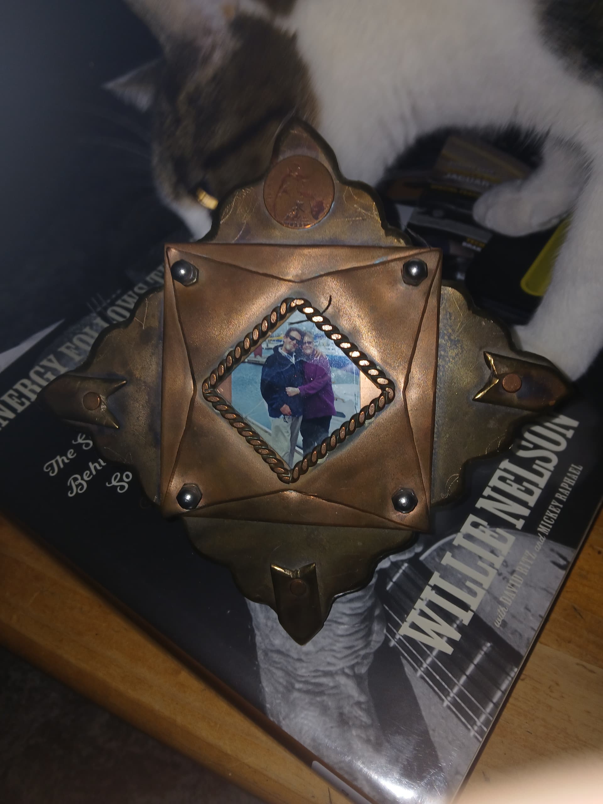

Here is a Brass and Copper frame I made..~*Stv
