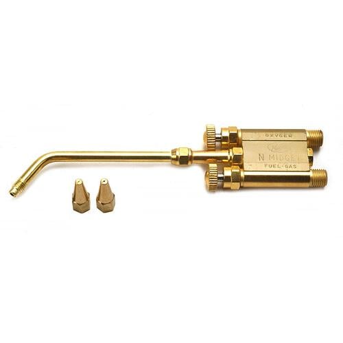

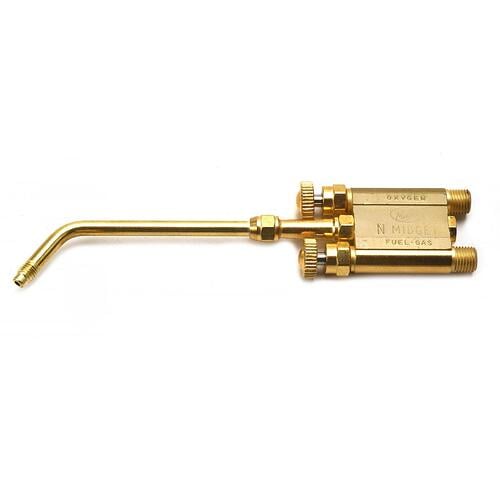

I am looking for a Meco Midget Torch. I’ve been looking everywhere I could find, and the only one I’ve so far found is a used one on ebay. I would prefer a new one, but if I have to settle for used then I will.

Thanks Rob. I had found TM; I’m having some difficulties in registering but ultimately I hope that won’t be a problem. I had also found Paige, and their assortment of tips is one of the things that has–for now at least–inclined me toward the Midget. Otto Frei is out of stock. I see Stuller has them in stock.
When you look at TM Technolgy, also look at their light weight hose set and tip extenders. I have both and am glad that I do. You should have no trouble finding a non-adjustable propane regulator for 1 lb. cylinders. Reconditioned O2 concentrators are hard to find. I am lucky to live 15 miles away from a small company that sells and reconditions them for large medical supply places. You can find all the fittings that you will need at a local welding shop. I use surgical hose to connect my concentrator to the first fitting on my setup. You can see pictures of it on my website at: https://www.robmeixner.com/shop-shots

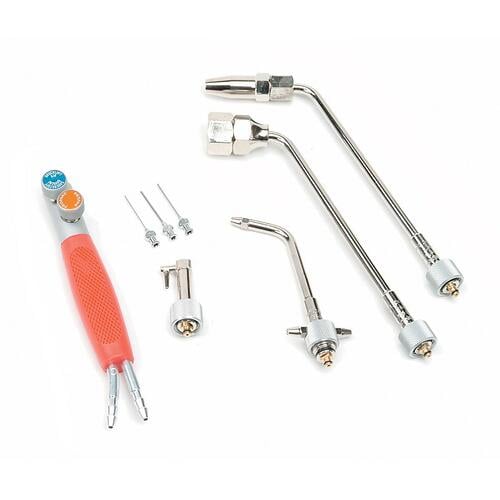

I just re-read your last comment. I don’t know what size work you plan on doing, but I also run a very old Little Torch in parallel with my Meco. I use it a lot more now that I have Paige tips on it. A Little Torch is a lot less expensive than a Meco and easier to find. I use the Meco to solder large bracelets and for casting and the Little Torch for smaller pieces, especially earrings and pendants…Rob

Another alternative is to get the torch body and the tips separately.
I will say my gripe with the Mecco Midget is that traditionally it uses thick, stiff, gas welding hoses. I’ve found the torch to be uncomfortable to use. It looks like more flexible hoses are now available to use with the Mecco Midget. That could be a huge improvement!

It was for me. When I first bought my Meco I was using heavy walled stiff welding hoses, big regulators and tanks of gas. The torch looked silly on the end of all of that heavy apparatus. I bought the type T light weight hose from TM Technologies and that completely changed the experience. I got even better when I went to an O2 concentrator and 1 lb. camp stove cylinders. As a comment, the Little Torch comes with a light weight hose. My Little Torch is probably 40 years old and has never been reconditioned…Rob

They are very different. The Presto-Lite has a big hot bushy flame that, in the right hands, can do a lot of good work. I did always find it hard to solder little jump rings on to small earrings with it. Then again, I almost never changed the tip as I was just too lazy to do it. The same is true for the Meco. If I need a smaller, finer flame, I switch to the Little Torch. If you are going with Paige tips, remember that, with an adapter, you can use them on a Little Torch as well as Meco as long as you are using propane. They don’t make acetylene tips. I even have an adapter for my old Hoke torch. Before you buy from Paige, you might give Rodger a call there and explain to him what you are doing. He might be able to give you some good advice. I always say that there is rarely only one way to do what we do. This is true for torches. Dad started with a gasoline blowtorch as that was all he had. He eventually went to a Presto-Lite and then a Little Torch. I have his old Little Torch and use it every day. He tried a water torch and quickly decided that he had wasted his money. He could never keep it going. Good luck…Rob
