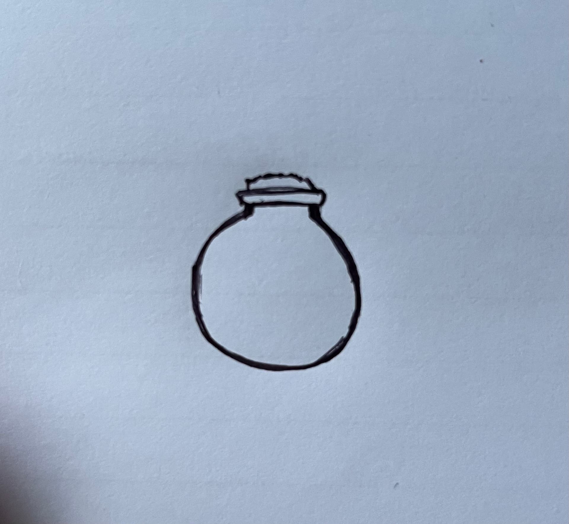

I intend to then solder the bezel slightly raised so that the light can penetrate from underneath (they have an open back): by bending the ring shank slightly and soldering to the edges under my inside bezel wire. I presume I can just measure the width of my bezel, take away how much I want the bezel to be raised by x2, and subtract that from the total length of my wire for the shank? Or is there a better way?

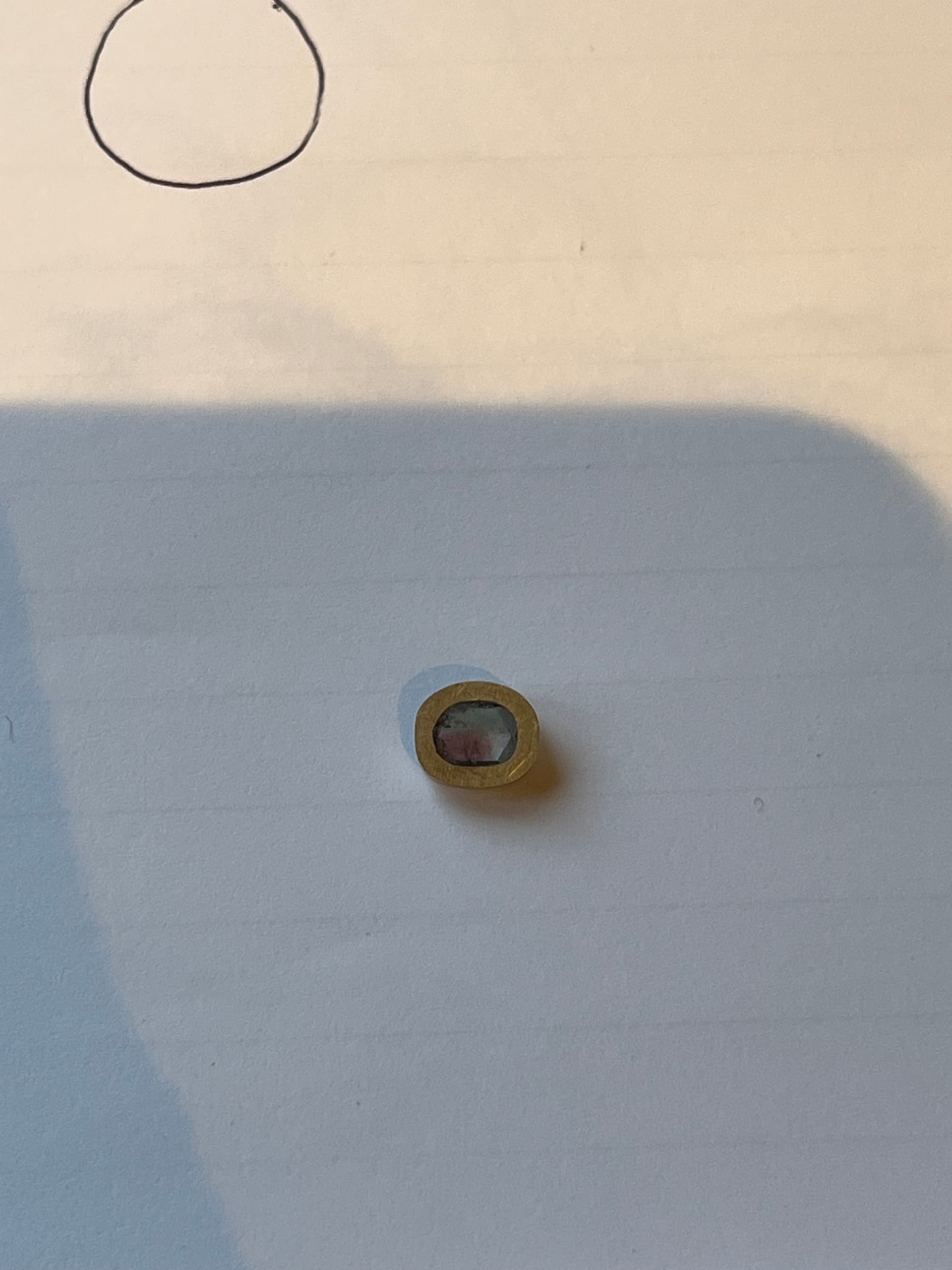

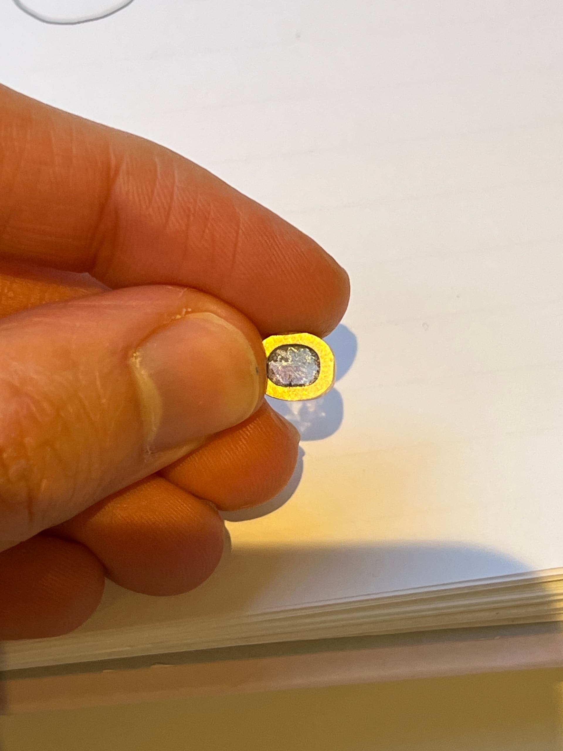

I post a photo of the bottom of my bezel and a quick drawing of my intended design.
I don’t want it to be raised too much, just a mm or so so that the back of the stone doesn’t sit directly onto the skin.
