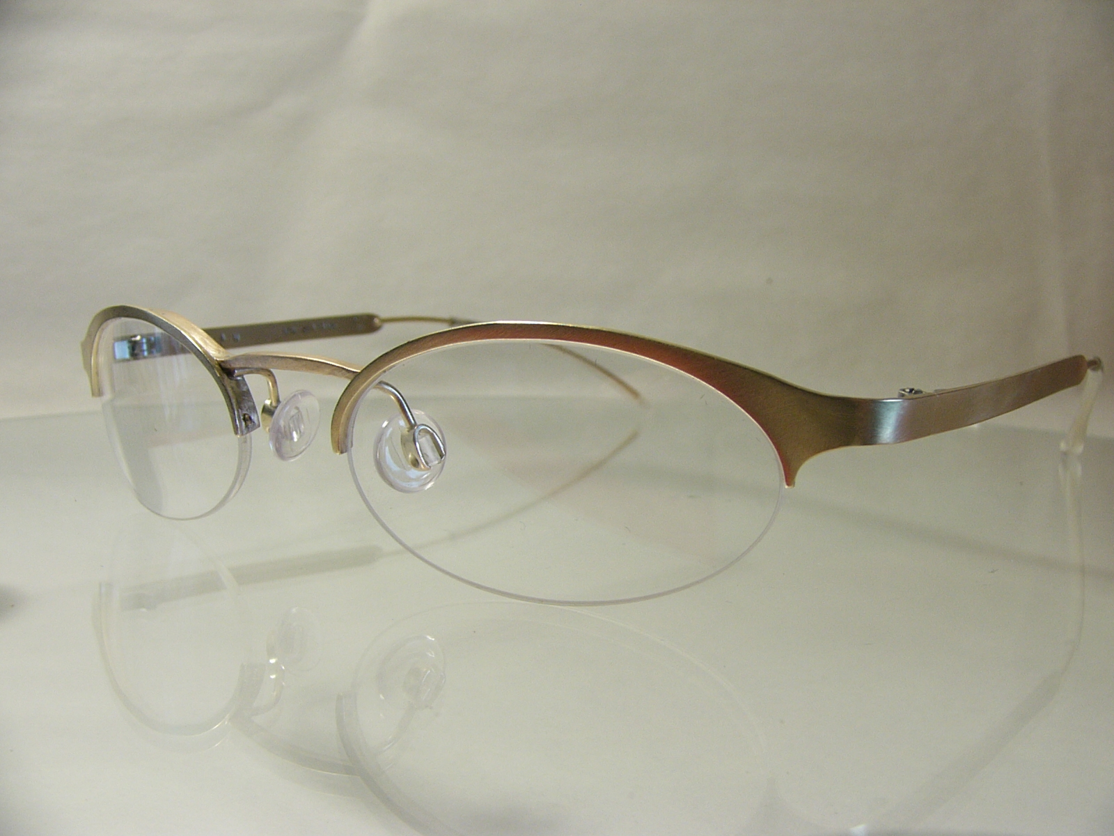

Mine are half-frames, using a mono-filament fishing line set in a
groove around the outside edge of the lens to secure the lenses to
the gold frames.
Pictures!!!
the gold frames.
Pictures!!!
I sense interest… great.

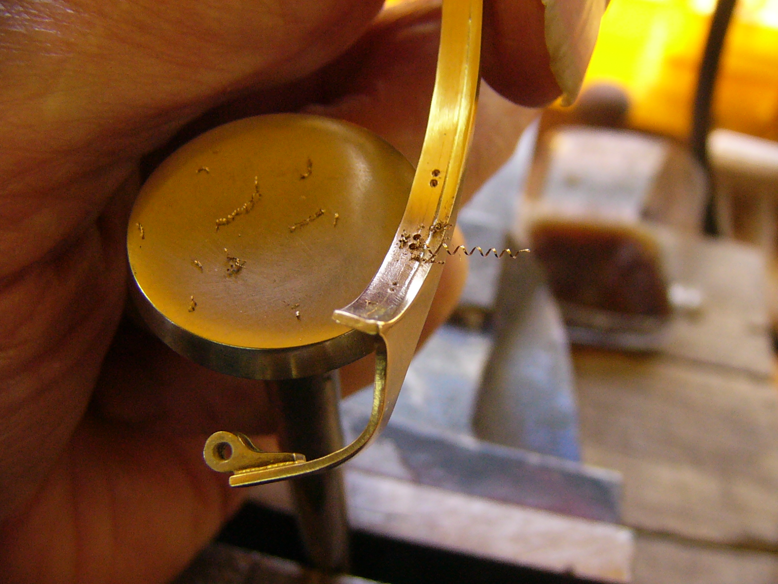

This is how I held the lens in a recent 9k frame, where the lens
shape is only partly metal. I drill 0.5mm holes like stitching in the
metal: http://www.ganoksin.com/ftp/01.jpg
Thread some same-size nylon fishing line:
The lenses have a 0.5mm groove cut in the edge. The nylon goes into
the groove. Stitching locates the lens to the metal frame, and the
nylon under the lens stretches across tightly and is finished with
two tiny holes near the nosepads:
into the groove. Stitching locates the lens to the metal frame, and
the nylon under the lens stretches across tightly and is finished
with two tiny holes near the nosepads: ganoksin.com/ftp/15.jpg
Sorry, it’s not 15 but 20:
Brian
Auckland
New Zealand
www.adam.co.nz
