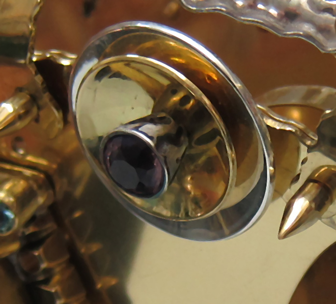

This eye is on the Fodiator Bow.
The tube screws into the head through polished brass and silver cups.
On the tube, which was made of 1.5 mm thick metal, I engraved/removed a recesses with a 2 mm ball frazer.
Then I blackened the tube with Liver of Sulphur and then I polished everything up again.
This left black marks down the side of the tube in the recessed areas.
I cut an amethyst in a standard brilliant and then set it in the conical shaped tube.
The convex shape of the brass cup reflects the sides of the engraved and colored tube, giving an interesting pattern in return.
I think there is lots of potential for this technique and I have used it on several occasions in rings and pendants.
