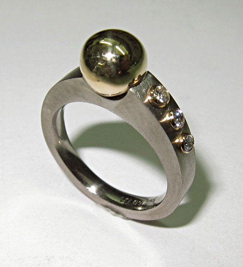

I posted a couple of pictures blog on how I made this titanium ring.
(Hope the picture comes out)
Anyway here is the link to my Ganoksin blog

I do have a question about the process description. You said that
you “peened” the wires over on the inside of the ring - does this
mean you hammered them over? Also, did you create a slight flare at
the ends of the holes in the ring on the inside so the wire would
then lock in place like a rivet? I apologize if these questions seem
overly rudimentary, but I just want to make sure I understand.

Hi Donna,
does this mean you hammered them over? Also, did you create a slight flare at the ends of the holes in the ring on the inside so the wire would then lock in place like a rivet?
Exactly correct
I drill a 1.5mm hole and then use a 2.2mm ball frazer to make a
flare on the inside of the ring.
I peen it over using a ball punch or my Gravermax.
Hans.
