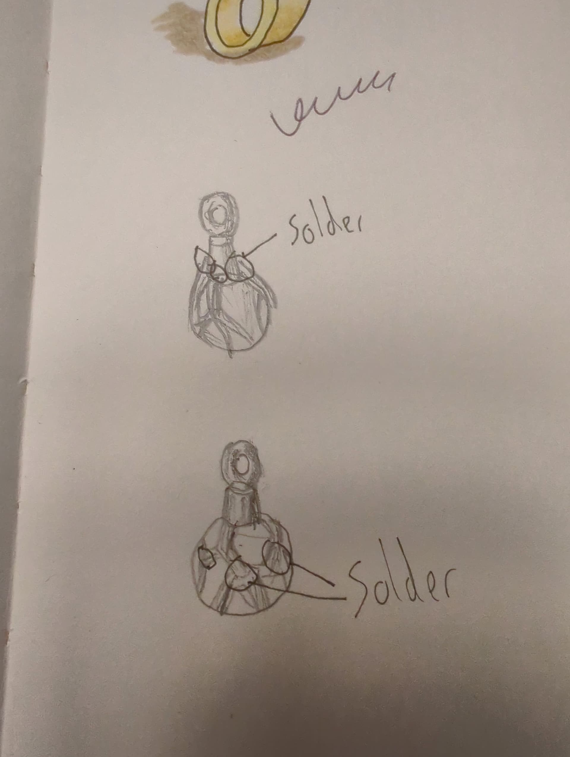

jeff-g asked for an image. I drew a diagram.
The idea is to have metal enveloping the pear. So either soldered slightly above the pearl (top) or right on the pearl (bottom). I take it the second option would be out of the question. The top, maybe?
Thanks for sharing your drawing! Now that we can see what you’re considering, we can see that there’s no space between the metal and the pearl or at least almost no metal between it and the pearl. I’m going to go with what some of the others are saying that it’s going to be difficult to guarantee there won’t be any damage to the pearl.
If it’s an inexpensive pearl, you’re brave, have steady hands and are good with a laser welder you could try it.
Poodlepup3’s suggestion of using polished silver as a shield sounds like it could be very helpful in some situations.
