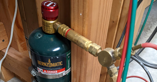

I do the same as Neil. The only difference is that I run two torches in parallel, a Meco and a Little Torch. The only thing that I can suggest, and I don’t even know if it is possible, is to make sure that the flashback/check valve isn’t installed backwards. Attached are pictures of my setup…Rob

I have the exact same arrester (Western Enterprises). Have either of you heard of a flashback arrestor locking? I’m wondering if I have to replace that part next. When i blow through it, it won’t flow.
OK - I’ve spoken with Western and Little Smith. Time to replace the flashback arrestor.
