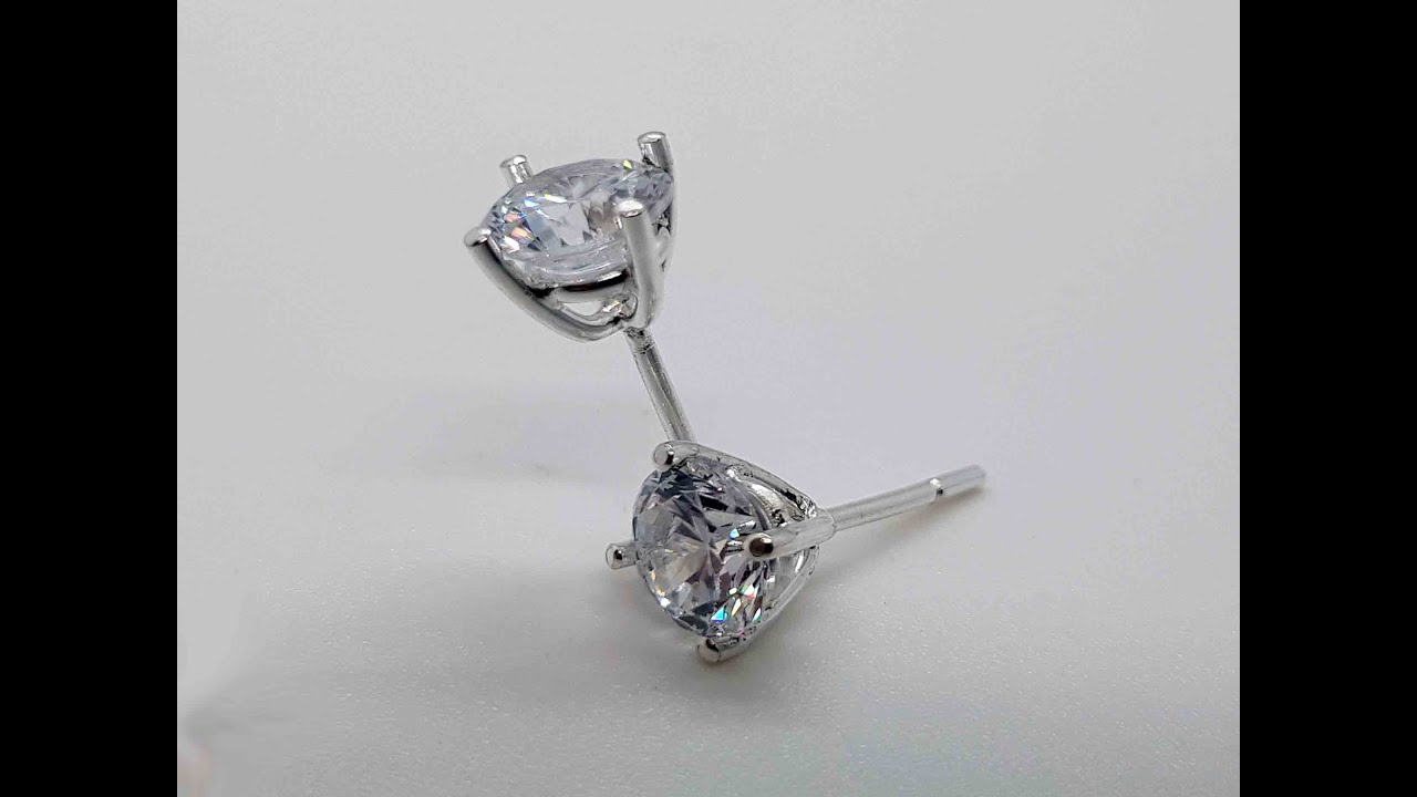

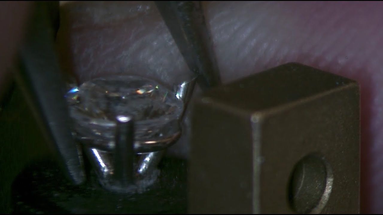

Here is one video (youtube) on setting martini earrings.
The closeups are dark but viewable.
Closing the prongs overhead as seen in the video looks very risky to me, too easy to chip a stone. Perhaps a different kind of setting pliers would be better? There is quite a variety of setting pliers.
I’m wondering if adjacent prongs can be pinched together horizontally, rotating around the stone then changing directions, or if that would only work at the very end. I’ve done that with 4-prong settings at the end, don’t know if that would work with 3 prongs.

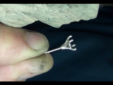

these two video’s might be helpful

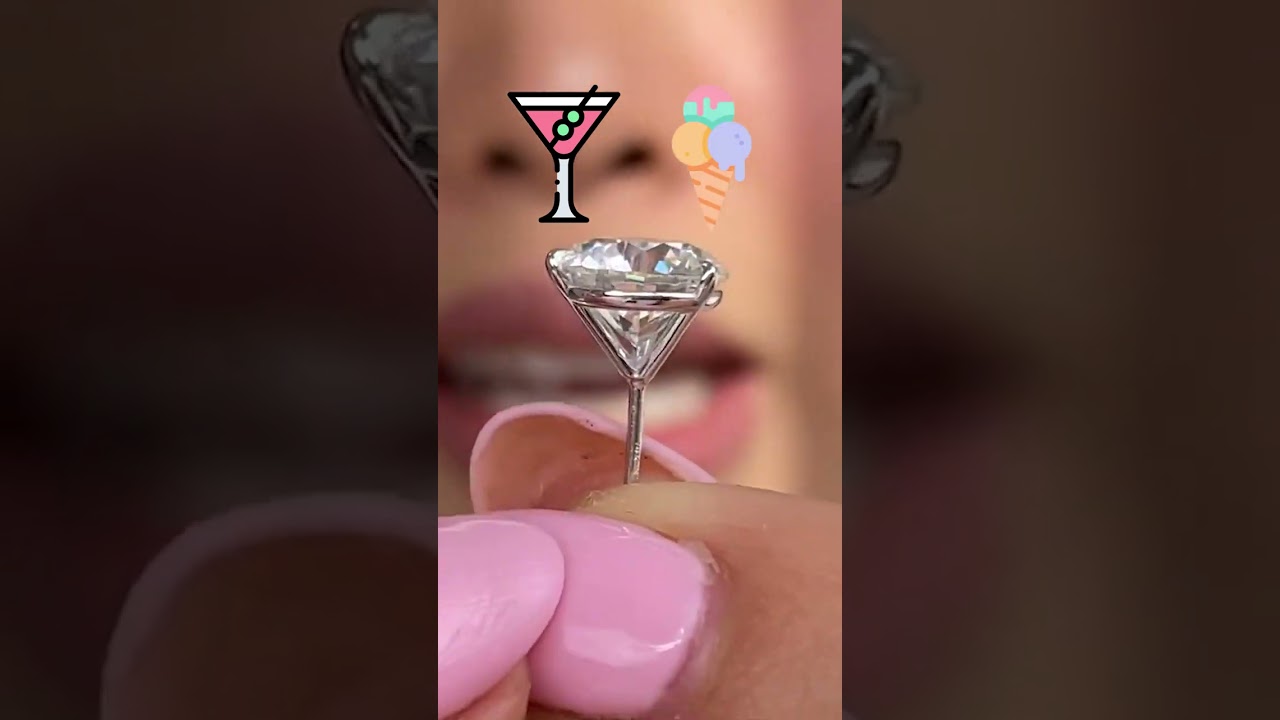

the below short video shows what i think yiu mean by martini setting…
observe…think about how it is put together
…similar to the above first video

Three prongs is the defining characteristic of the martini setting. It has to have a girdle wire because otherwise the three narrow prongs could easily be bent, loosening their grip on the stone.
I don’t think that special clamp is really necessary. A good pin vice should grip the post well enough when cutting the seats.
