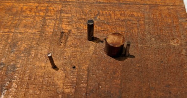

Jo, (and Rob), would either of you be willing to show your jigs and anchor points? I’d be most grateful

Could you please provide a close up of the modified pliers?

Following is a link to pictures of my modified pliers and old earring wire jigs. I find ways to use PVC all over my shop…Rob
