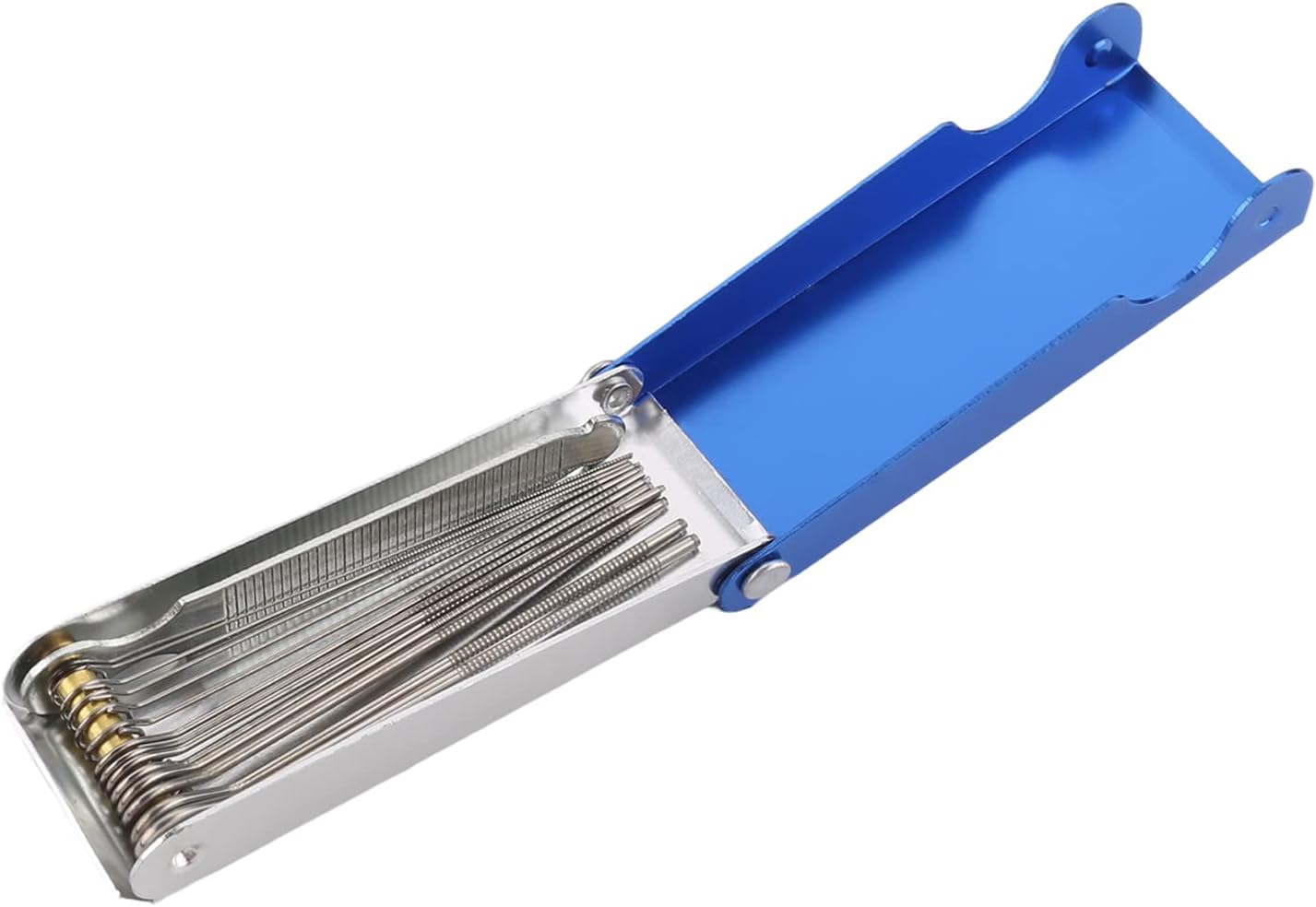

Thanks for the input. I finally got ahold of an ultrasonic, and between that and a set of cleaning tools (here:
and got the tip all cleaned out. Did a casting afterwards and it went perfectly. Thank you to everyone!
One thing that you should be careful about with those cleaning tools is not to get carried away and ream out your torch tip holes. It’s a very common thing to happen. Before you know it you can turn a Little Torch #5 tip into a #7 tip. Just something to be aware of.

Oh, good info! I usually just swish it quickly and rinse with water, but I’d hate to damage the tips.
