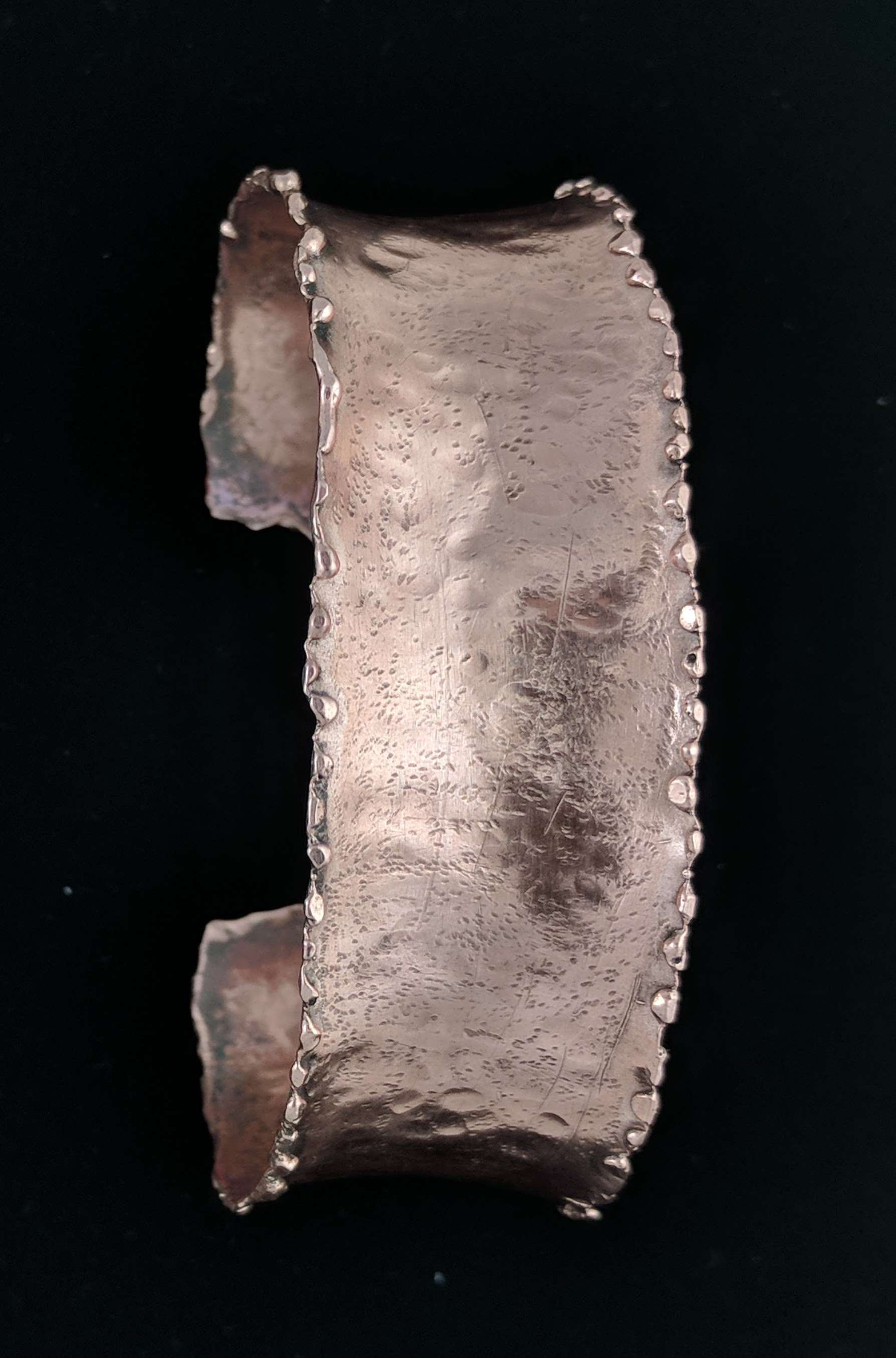

When I look on Pinterest I want to know how the copper cuffs have been melted on the exterior. I have a map gas torch from home depot
Can you post a picture of an example?
Use a really hot propane and O2 torch. Preheat the entire piece and then concentrate a small pinpoint flame on the area that you want to fuse. Be careful as it goes fast once it gets started. You can damage some tips doing this as they may not be built for this kind of heat. Good luck…Rob

Is it possible to do this with a #7 tip or the Rosebud tip on the Propane/Oxy Smith Little Torch?..thanks for the picture…interesting effect…all I have is a Little Torch.
I don’t know. I work with 18 gauge copper sheet. It is fairly easy to find and not very expensive. Try it with your torch tips and let us know. Remember to preheat the entire piece. You might also build a small heat reflective area out of firebrick if you have trouble generating enough heat. Depending on how you want the edge to look, you need to account for gravity and how the flame velocity will push the temporarily melted copper around. Good luck…Rob

The Mapp torch doesn’t have the variety of tips and thus the ability to focus the flame that you can get with a Meco Midget. The answer is you can melt big chunks with the Mapp torch, you can make pretty scallops with the Meco.
Since you don’t have a torch hot enough, you can get a nice look on the edge by hammering.
