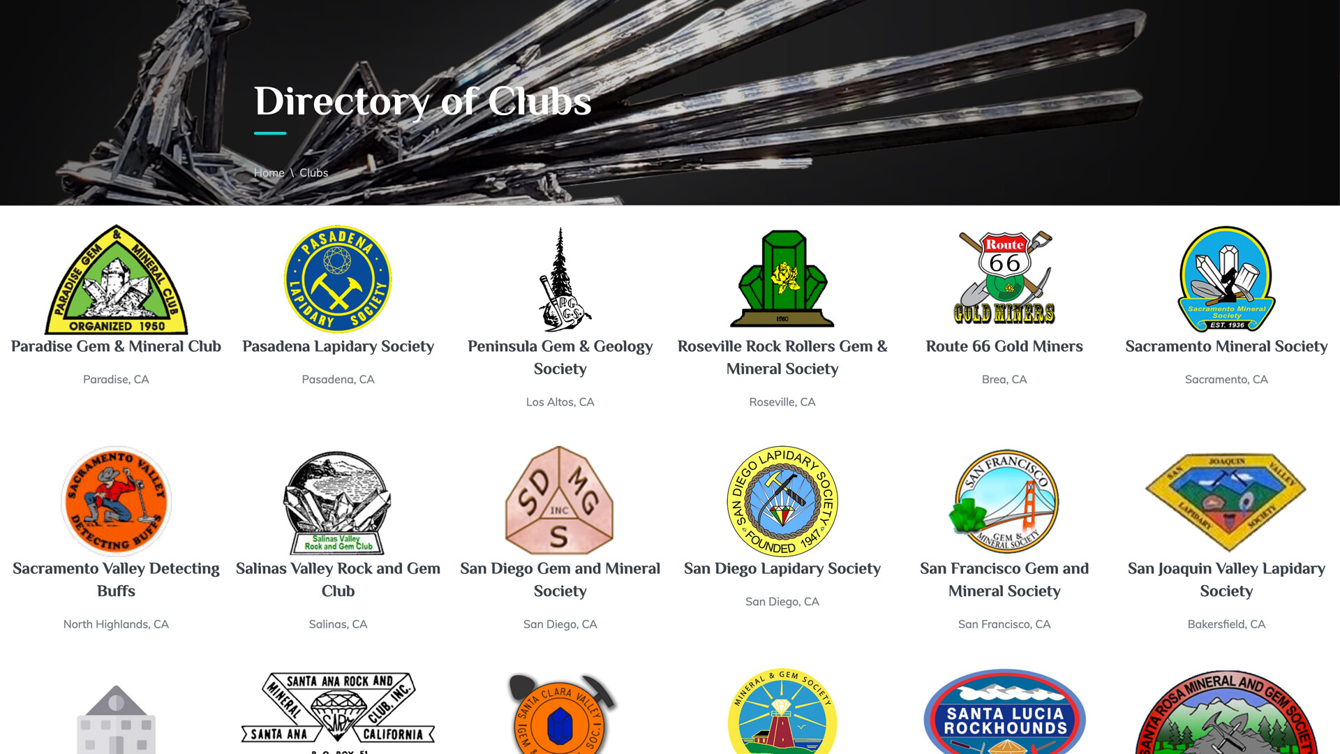

Following is a link to a directory of rock and mineral clubs. There are several more directories to be found. I belong to the Syracuse Gem and Mineral Society…Rob
Thanks, that’s quite a list, Rob. I’m a member of the Maplewood Rock & Gem Club in Edmonds, Washington. I’ve enjoyed reading your posts here for some years now.
Thanks…Rob
