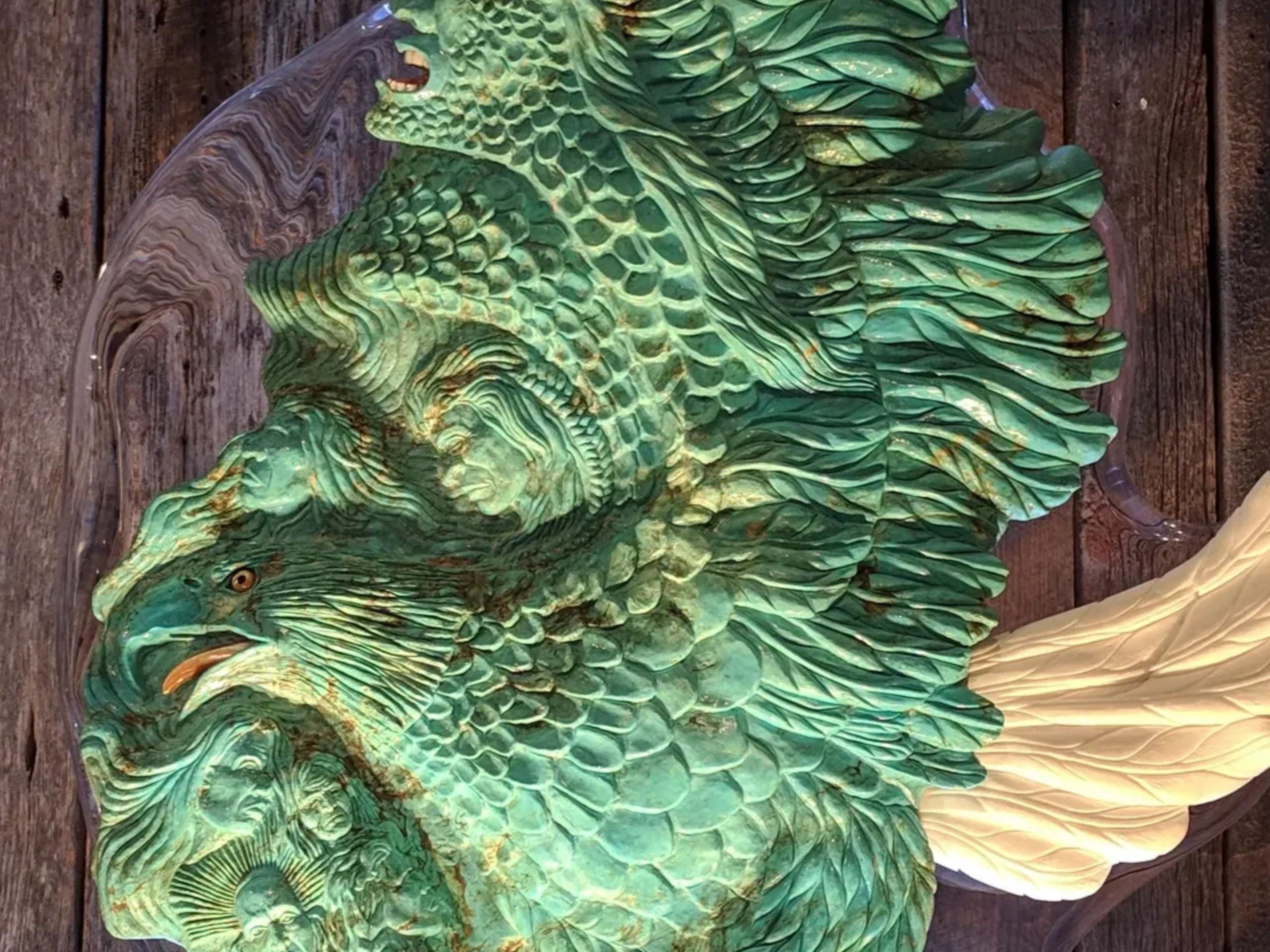

Tina…I’m brand new here to forum…74 years old and carving turquoise for a living 46 years …now pretty much retired. I could show you how to cut them in half using a 2" diamond saw blade on a 3/32 shaft in a flexshaft handpiece…no water needed just a vacuum or fan. Problem is it’s a trick to hold the stone and not cut your finger off! LOL…really got your attention now, don’t I ?! How many do you have to cut? The trick is using your thumb and trigger finger and moving the rest of your fingers into a folded fist so nothing is in direct line with the spinning blade. Others here have given good advice how to put them on dopping sticks to keep out of harms way as well. I can make you a short video of the tools and how to do it if you like. Is there a place on this forum to show videos?

Im humbled by your offer! I would love to see that technique, and from someone so experienced! I saw some of your work online.
I too am new here, so dont know abt video sharing. Ideas anyone? Youtube would b another option. Thank you. Love the sound of your option.
OK Tina, let me get my techno savy wife to help me out here. I’ll talk with the folks at Ganoskin about video as well.

Well sorry for the delay Tina, been off the bench working on health issues. Will get some photos of tools and where I find them on Ebay and a shot or two of me cutting the stone.
