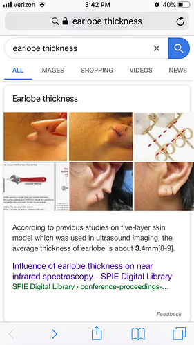

ok in response to my own question above, i did find one thing on google that stated that the average earlobe thickness (in the study) was 3.4mm
so, i think i will start with an opening of about 8-10mm…
julie
