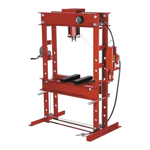

Not a jewelry-size press, may or may not suit a blacksmith, but Harbor Freight has a 50 ton press at a steal of a price:
I used a Harbor Freight 20 ton shop press for some years, and while a Bonny Doon is much nicer to use, the HF press did the job.
