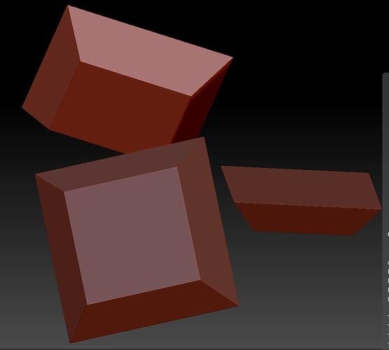

Hi Andrew. Here’s the cut I’m talking about. Super simple but this is how the original ring from the 1700’s is. Perhaps called a coffin cut now? Very easy to cut but the issue is if it’s only 8mm by 8mm by 2mm high, can a typical lapidary person do that or those people only cut larger stones? The other issue is that the original ring had heavy inclusions in the emerald so I can’t use lab created ones I suppose.
Not that I want to, I could try to do something like that on my lapidary equipment. I think that you would be better off looking for someone who facets if you are looking for precision and quantity. Others may have better ideas…Rob
Andrew, what you show is a typical dimension for a medium to large sized stone for a ring, altho’ it is thinner than the usual stone. Very easy for any decent faceter to cut for you, only six facets The only technique issue is the large bottom facet, assuming that you want that polished rather than frosted, but it’s not a big deal, just takes a little more care and time. Given that the average cutter charges about $150 to $300 for a five carat stone with about 57 facets, a rate for what you want would be much less. It would be less than an hour’s work, I think. Bigger cost would be the rough, depending on what you want…but one could use thin rough that is not useful for larger gems, so there’s that to consider, too. A faceter might have a suitable thin piece in inventory that wasn’t suitable for a larger stone. -royjohn

I think ? you mean what Rick showed.
Andrew

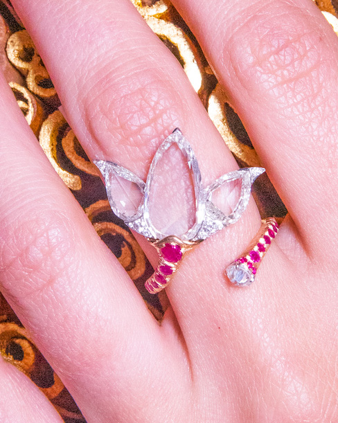

  • Maybe post some pictures of the ring?
  • I would classify [using some CAD terminology] the objects you posted in your rendering as truncated pyramid.The top view object appears to have a square base.

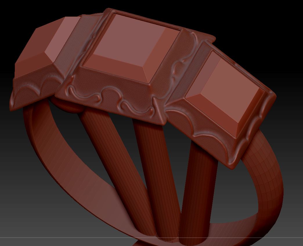

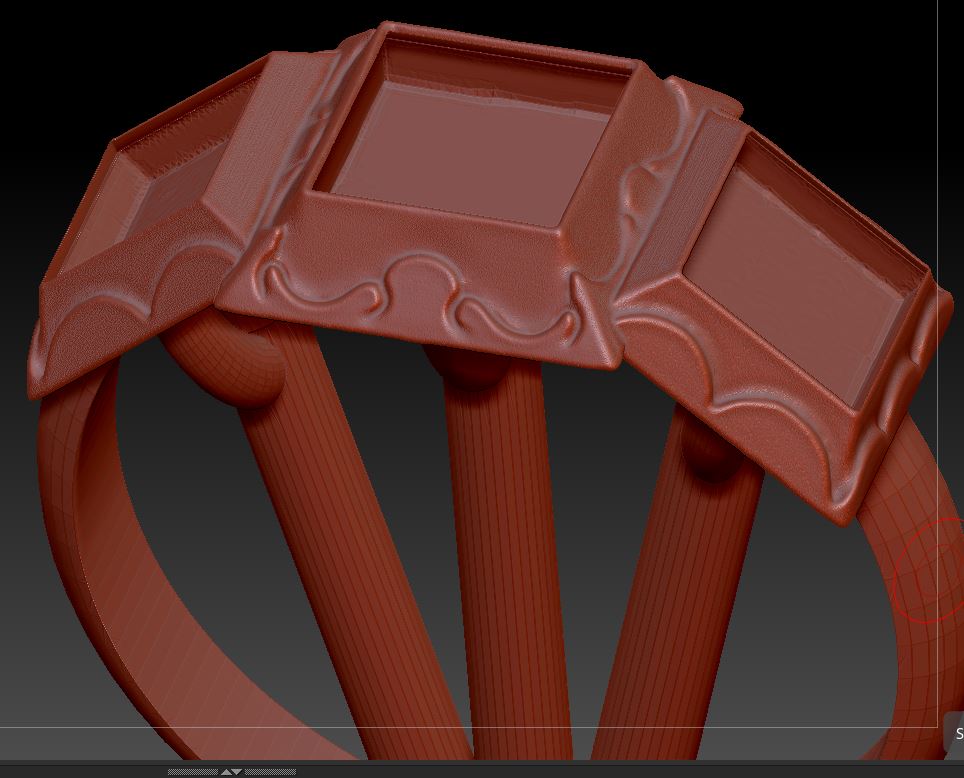

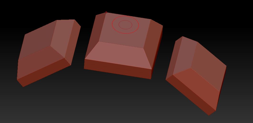

Hi Rob (and Andrew was curious about this). I finally finished what I think should be the final stone shape in order to replicate the old ring. I added as much height to the stone the setting would allow so that the color would not be transparent. I am not very good at sculpting details from scratch in Zbrush so I had someone help me on Fiverr. Anyways, the final stone size would be about 7 by 7 by 3mm high for center stone and about 6 by 6 by 3.2mm high for the 2 side stones. As you can see from an image of the original, the center emerald has a lot of inclusions or cloudiness from being in the water a long time. Amethysts seem kind of imperfect as well. Got any suggestions on where I could get stones made that look like the original instead of perfectly clear gem quality? (I don’t even know how to get gem quality ones either). I tried asking Lambert in Thail
and some questions by email but they never got back to me. I think you just send them rough large stones and they cut them based on the stone, not the size? Or I can give a size?
Please check my pictures when you have time and thanks for asking.
I looked at the pictures and will suggest the same as before. While these cuts could be made by a lapidary (not me), you might be better off looking for someone who facets. I believe that royjohn is one and he might have some suggestions. I don’t remember what the stones material is, possibly amethyst and ruby. Flats and sharp edges like these may wear quickly. The lower edges don’t appear to have any angle to them to allow the bezels to be pushed over and hold the stone in place. That being the case, the setting has to be deep enough to allow the metal to be pushed over the sharp angle at the top. Good luck…Rob
Yeah I did my best with the main goal of replicating the dimensions and the details of the original. The original sharp angle stones lasted 400 years being bounced around in sand on the ocean floor hurricane after hurricane. (But maybe it was buried pretty well, usually they blow sand off before they find stuff). If the stone setter doesn’t like the bottom part with no angle, I guess they could omit that but the stones would only be 1.5mm high which I think would make the stones too transparent. One solution to use my stone dimensions would be to cut the corners, slide the stone in, and solder them. Or I can simply cast the stones in place but not confident it would look as good. There’s a local professional jeweler I’m going to ask if they will help me with this project since I don’t really know what I’m doing.
I just realized that if I keep these exact stone shapes, they will have to be set from under the ring and then some pieces can be laser welded to make a bottom seat? so I will fix that. Thanks!
