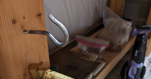

I currently have flashbacks on my 1 lb. camp stove propane cylinder and O2 concentrator system and it works fine. I have no idea what the pressures are, it just works. I have had a small flame at the torch extension and tip joint, but tracked it back to the fact that the tip was not tightened. I don’t recall what tip it was or if it was even on this torch setup. It happened a long time ago…Rob

I really don’t remember. Either Otto Frei or my local welding store. Following should be pictures…Rob
I forgot to mention, they are Western Enterprises. They have a fairly helpful website…Rob
Thanks, Rob…I’ll probably take part of my setup down to the local welding supply, so we can match the threads right…
Thanks for providing the images Rob. They really are helpful.
Glad to help…Rob
