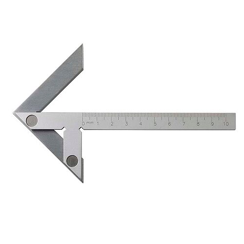

here is a general purpose centering gauge…but it us for finding center on a round disc…

oops! i neglected to post the link to the center gauge earlier:
is this what you found?
Julie
No, but thank you. I think the idea I’ve come up with will work pretty well though. Many thanks.
