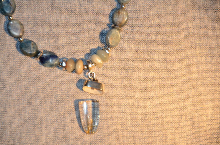

I made a deep (~4mm) bezel for a rutilated quartz tongue that I’m
using as a pendant. The tongue has very little taper near the base
and I know that rolling down the bezel on it is not going to hold it
long term.
I’d be interested in any opinions on whether epoxy or cyanoacrylate
would be better for cementing the stone into the bezel.
A couple of (not-so-good) photos will illustrate:
http://www.ganoksin.com/ftp/DSC_1615.jpg
http://www.ganoksin.com/ftp/DSC_1617.jpg
Thanks.
alonzo

Thanks everyone for the replies. You confirmed my own thoughts. Epoxy
it is. Cutting a grove around the stone for some extra grip was a
good idea too.
– alonzo
