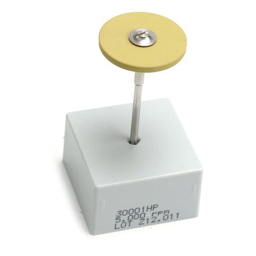

on a related note…after the graver has been shaped and polished, on the powerhone…or stones…they can be quickly touched up (by “hand”) using the below diamond polishing wheels, in a flexshaft…
some people mirror polish the face and heel…but the heel polish is what affects the surface mirror finisj bright cut
