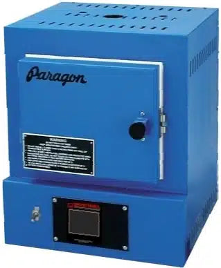

I have a Paragon SC-2:
I originally bought it over twenty years ago for heat treating small steel edge tools (I used to make small hand planes and other edge tools for woodworking). I recently began doing enamel work and started off doing torch firing. Then I tried using my Paragon and discovered it produced far superior results. The only problem was that I wanted a door having a window so I could watch the enamel go through the various stages during firing. I contacted Paragon and they sold me a new door with a built-in window that was dirt simple to retrofit onto my kiln.
I now love using my Paragon for enamel work. They make purpose-built enamel kilns, but I’ve not felt the need to upgrade. My SC-2 works great…

I have an SC-2 kiln, too. I have used it for enameling when I teach away from my studio. It’s lighter than the ceramic brick-lined kiln I use in my studio for enameling, reserving my SC-@ for metal clay. I like the manual control of the b-lined kiln and the bricks really hold the heat. It, too, is a Paragon, though I don’t think Paragon is making these anymore. I’ve been using it for 20 years and the SC-2 for at least that long. They are both reliable kilns, clearly.
We have the SC-2 kiln where I work used as a lost wax casting burnout kiln (not for enameling). We had to move to a temporary location with less space, so we had to get a smaller burnout kiln. It took a little bit to figure out how to program it. It has a different programing system from other Paragon kilns that I’ve used. Now that I have it figured out though I like it a lot. Other’s are saying that it’s a good enameling kiln. I’m sure it is.

Enamelists use a very wide range of kiln types. There are those who only use a beehive kiln. There are those, like me, who generally use a small, brick-lined kiln with a built in pyrometer and no controller (manual control only), and sometimes have used a fully digital kiln when teaching. There are those who ONLY use a digitally controlled kiln. There are some who swear by their Vcella kilns (and what’s not to love, except the price. . . these are the Rolls Royce’s of kilns), And on and on. If you were to ask me what I would suggest: the Paragon SC2 or SC3. You can sometimes find them on craigslist or ebay slightly used. Do not buy one online if there are no photos of the inside of the kiln. A small crack in the inside walls doesn’t matter. A seriously huge crack would be a problem. These kilns are workhorses and are incredibly durable. So a used one, if slightly used is worth buying. Read all the information supplied by the seller. However, if you are concerned about buying used equipment, then save your pennies, drachmas, dinars, gelt, and buy a new one. And if you are independently wealthy, go for a small VCella. With either the SC’s or the Vcella. The SC’s weigh about 30-ish pounds. The Vcella’s are heavy heavy heavy.
