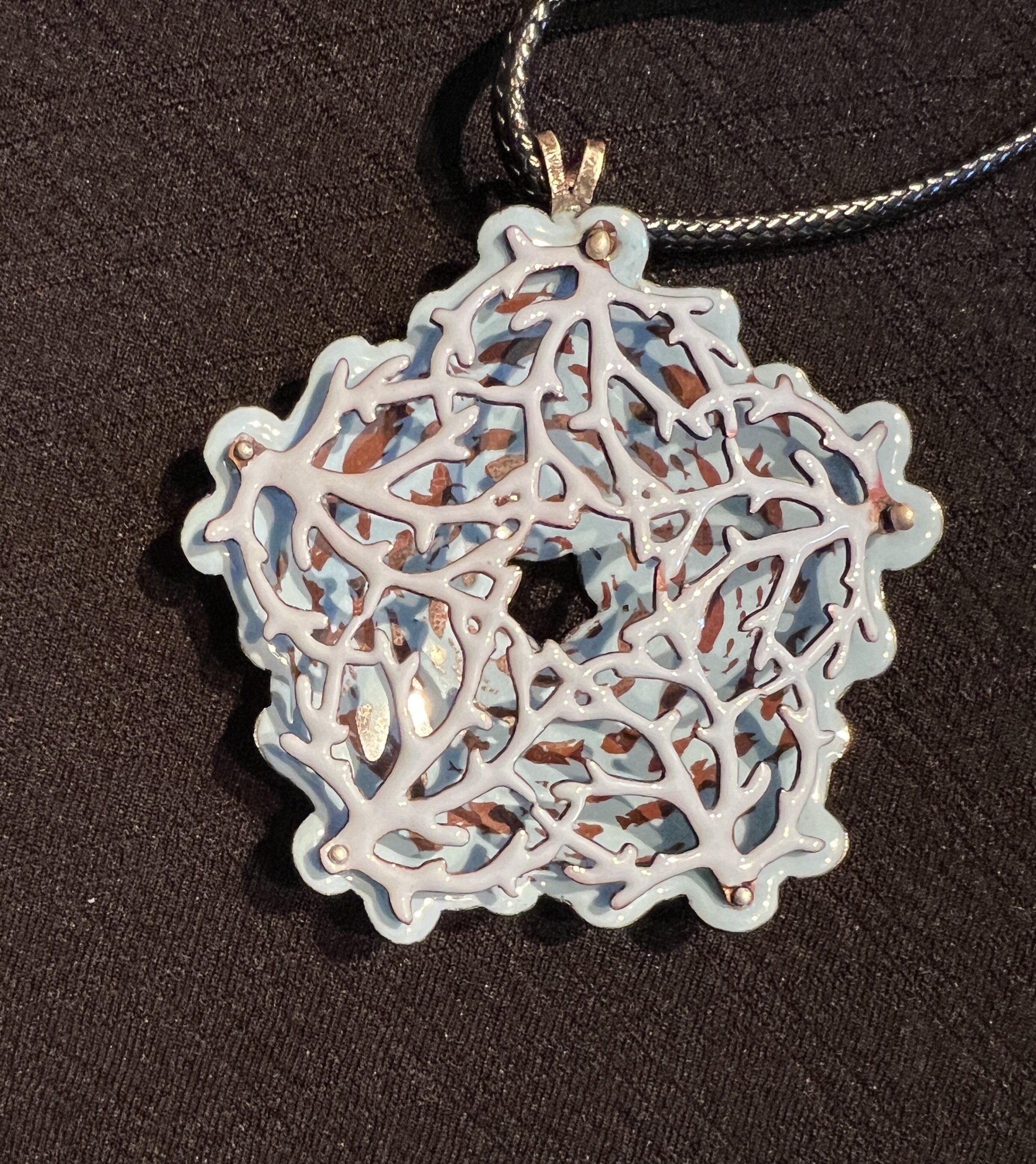

This is a piece I made recently. Is this what you’re talking about?
It’s pierced copper (22 gauge, iirc), slightly domed, with one layer of counter enamel and two layers on top. All Thompson’s unleaded opaque. 3” in diameter.
Since you’re talking earrings, this example may be too big. Hope it helps, though.

That’s a cool piece and way more complicated than I am thinking about. I just pierce simple designs like trees, leaves, and abstracts that are basically just different sized lines defined by the size of the blade that I am using. Since I am brand new to enamel, I am just curious how narrow a line can get before the capillary action of the enamel jumps over the line. I am experimenting now and may eventually figure this out if I can stop just melting the metal as I heat the enamel. Thanks for the help. I have been making jewelry for a long time, but enamel is a whole different relationship with metal than I am used to but it has been a lot of fun so far…Rob
