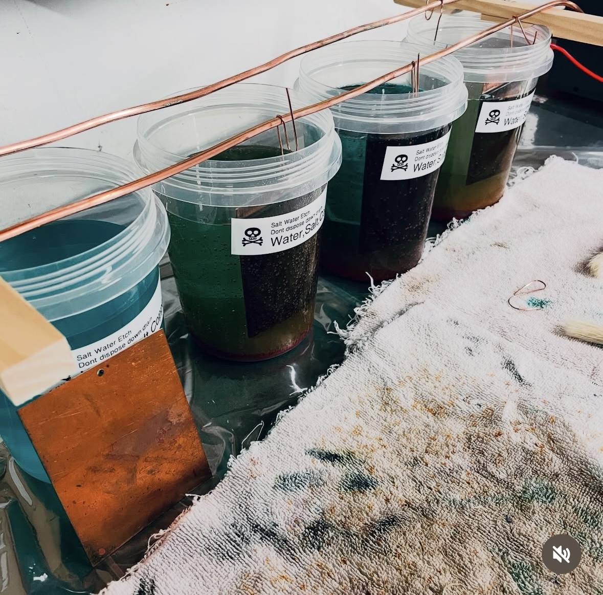

Here’s a quick pic of a setup I used so students could etch their pieces individually during a workshop I taught at Snow Farm.
I used two 6g rods of copper as bus bars, which allowed us to run current using a 30V @ 0-5A variable power supply. The ends of the bars are raised up off of the plastic containers on each end by a small block of wood so they don’t melt into the containers. This setup allowed each student to etch their piece by hanging them from a copper lead off the positive rod. There was a corresponding copper blank hanging from the negative.
They used Sharpie oil paint markers as a resist, but you could use others. We used a super saturated salt solution with 1/4c of citric acid added per gallon. These 4 containers used a gallon. The citric acid chelates/binds with the copper that’s being etched away allowing it to fall as solids to the bottom of the container. This makes cleaning out your bath much easier as this solution can be used indefinitely with the occasional addition of salt.
I have a larger dedicated container in my shop with a salt water bath to etch larger pieces with a larger sheet of copper as the negative along with the power supply. I use the 6g copper bars and wooden blocks for this as well. The 6g copper can be purchased by the foot, off of a roll, from big box stores.
