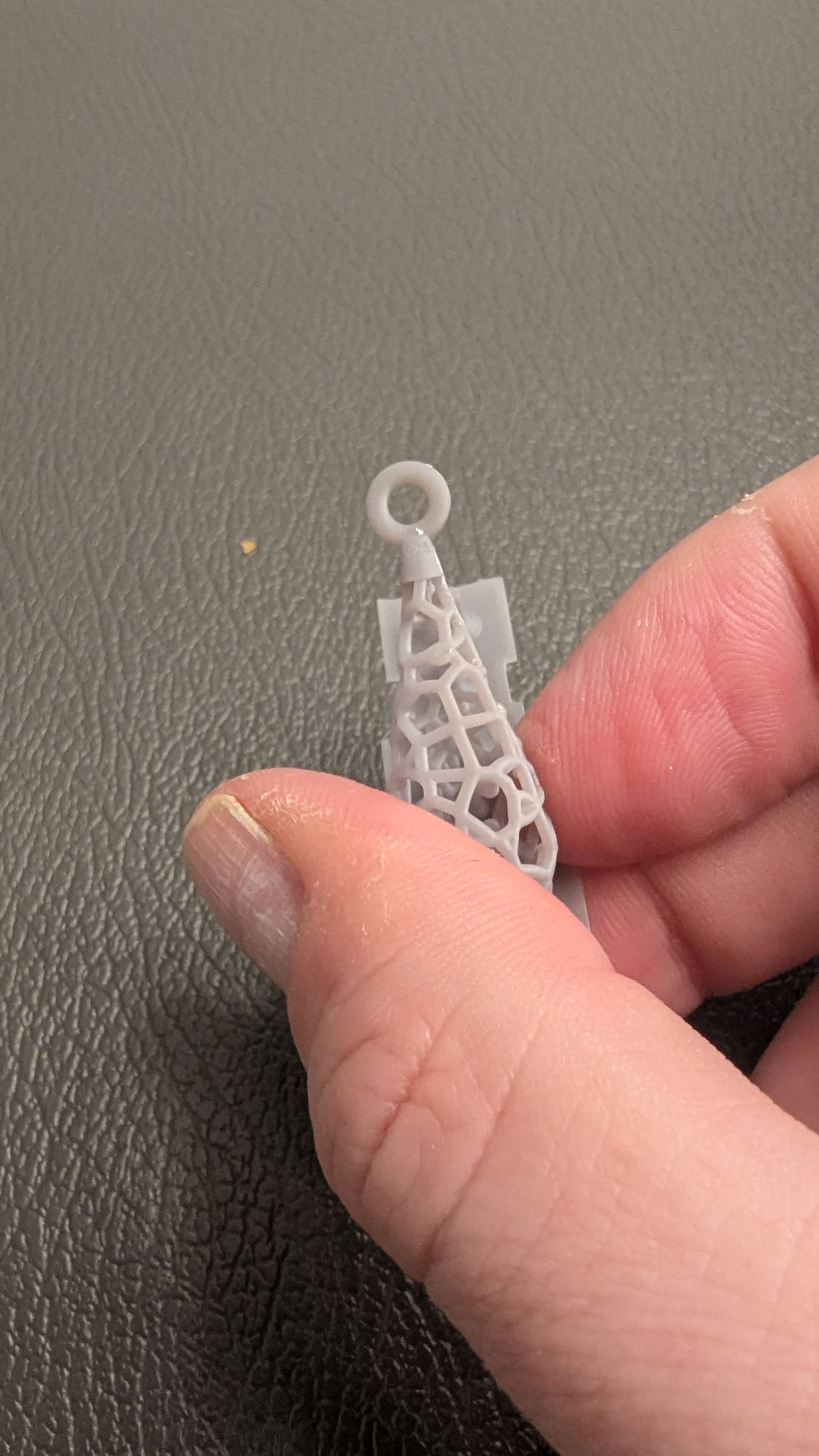

I am designing these earrings and the loop for connecting the ear wire is way off. Can anyone give dimension recommendations for the inner and outer diameter for the loop connecting the earring to the ear wire?

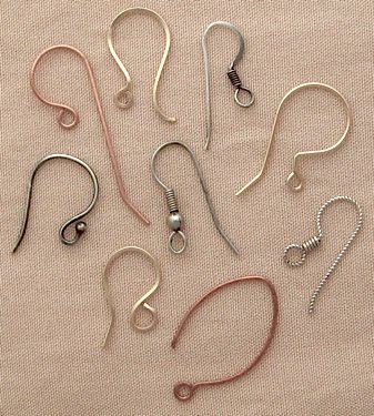

what size/ gauge wire are you using for:
-the ear wire diameter

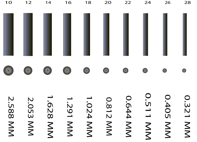

20 gauge? (approx 0.812mm)
19 gauge? (approx 0.912mm)
(i personally prefer 19 gauge for sterling silver, and 20 gauge for gold…others may have different suggestions)
see below article discussing ear wire sizes

I think that your problem is that the size of the ring is too large for the rest of the piece. I use 16 and 18 gauge wire wrapped around a 2.5 mm steel mandrel. Small earrings get 18 gauge, larger earrings and pendants get 16 gauge. Once in a while I will do 20 gauge…Rob
This is great Julie and Rob, thank you so much.
