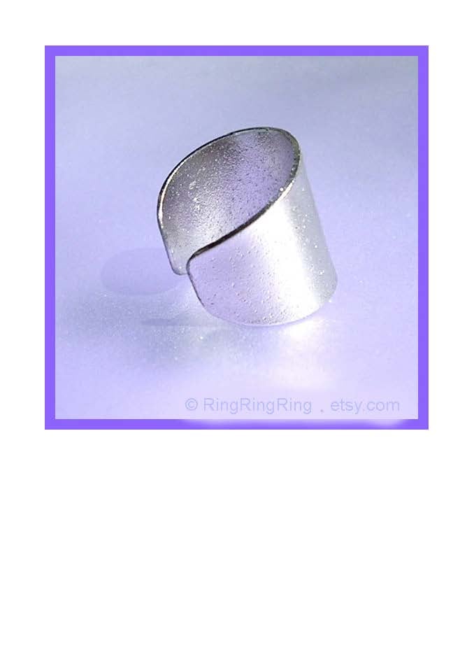

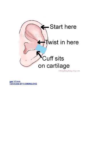

Hi Sharon I know the guy who patented the ear cuff decades ago, long
since expired.
He made them in fine silver. There is lots of info on the net even
how to make. From memory I think it was .7 mm thick sheet.
Believe it or not I found a PDF on ear cuffs in the computer.
When I googled “ear cuffs”, I came up with all sorts of interesting
ear jewelry.
Linda in central FL
