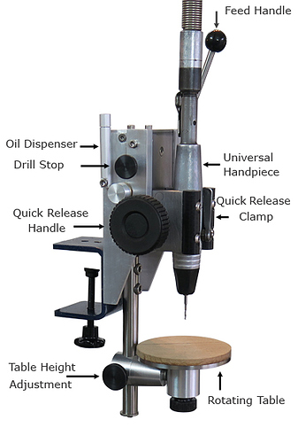

I have just finished designing and launching a Mini drill press for jewelers that drills normally, drills glass and stone etc.
You don’t meed another motor, just your existing flex shaft.
The basic model sells for $485 and there are many more vices and clamps coming soon
Check out http://www.drill-straight-tools.com/
