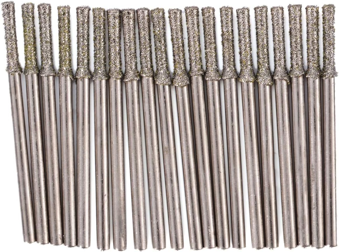

I drill holes in stones using “Diamond Coated Tipped Solid Bits” in my dremel in a drill press, similar to these, with a water drip. They are available in different diameters. I then use a small diamond ball bur to clean up each side and make the holes a bit concave. I would recommend dulling the bits down a bit by breaking them in with some agate. You can also get really clean holes by half drilling, then flipping over to do the other side. A divider is used to make two marks that are at the same spot on each side.
