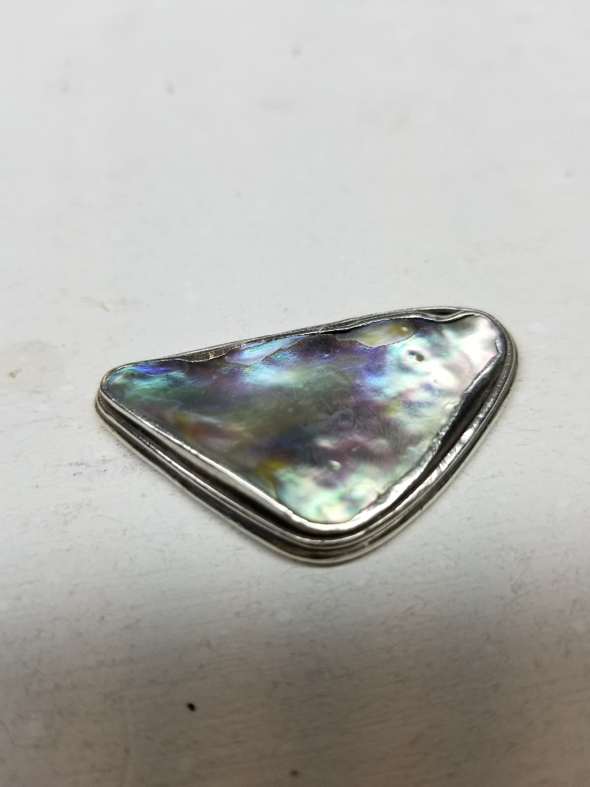

(not sure how this image will show) Do you mean something like this? Original ring (not my work) needed repair requiring removal and resetting of the thin and delicate Paua shell. I filed the top of the bezel down to meet highest part of shell, filing bezel closed with half-round file where the shell surface dipped.
I’ve done stones this way, too but images are not readily at-hand.
