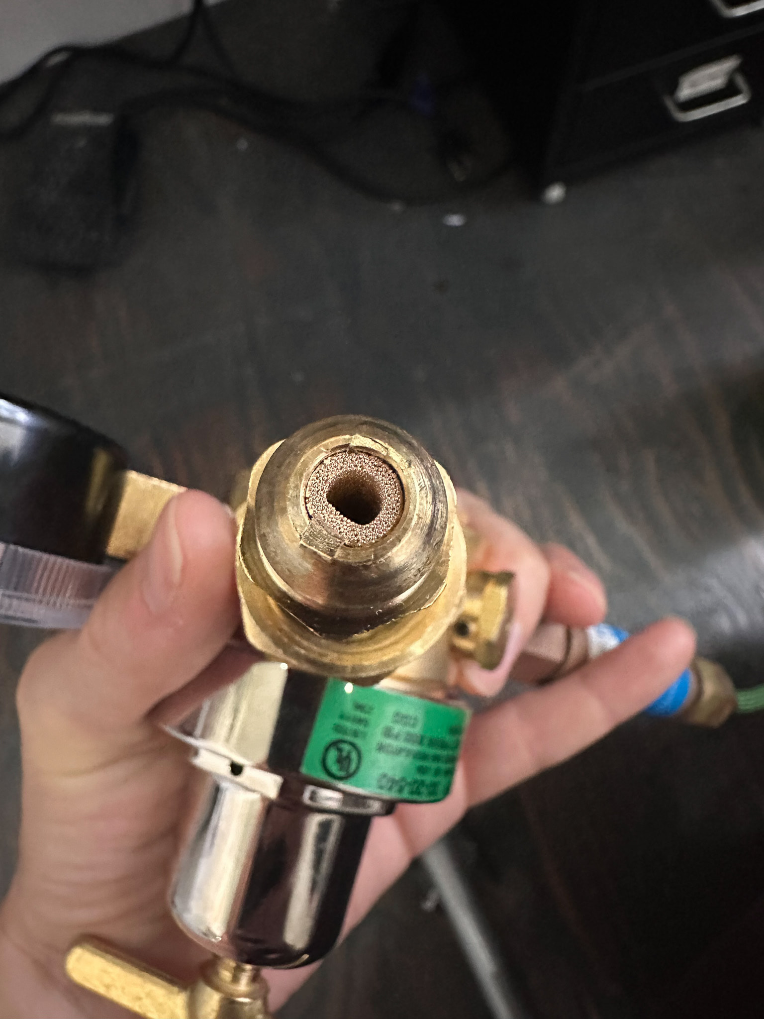

Does this oxygen regulator look damaged?
I just got this oxygen regulator from Cyberweld today and I noticed a dent in the tip where it connects to the tank. Thanks in advance for your input!
Did a manual come with it with pictures or diagrams of the regulator. Call Cyberworld and ask about it. Take it to a welding shop and ask about it. I have two old O2 regulators and neither has anything that I would call a dent in the end of it. I would suggest not using it until you get an answer. Good luck…Rob
Thanks I went to the welding supply and they replaced fitting for me. It’s definitely not supposed to look like that and the dent caused the fitting to not make good contact with the O2 tank which caused the leak. $20 for the part and repair. Tested and no leaks. Good as new! I have a market coming up in a week so I had to act fast. Thank you for the feedback! I’ll be contacting cyberweld next…
