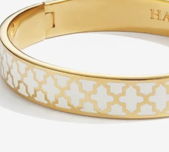

I need to create bracelets with a consistent look - fine enamel detailing on silver, please see the kind of thing I am talking about below…
I will need a manufacturer to be able to recreate the sample many times without looking ‘artisnal’ (no blemishes, no wonky lines, no enamel overflow)

In the designs you’re showing, I would guess the areas for enamel are initially recessed in the metal. The spaces are cut into the metal, then those recesses are filled with enamel, and the whole top surface is sanded smooth and polished. Creating the spaces in metal, either by casting or machine, would give you consistent smooth straight lines. The groves or spaces don’t have to be very deep.
