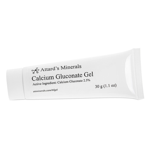

Keep Calcium Gluconate gel on hand and apply to any area you have
spilled Dip-n-Etch on, go directly to the emergency room. This gel
can be purchased from Attard’s Chemicals
