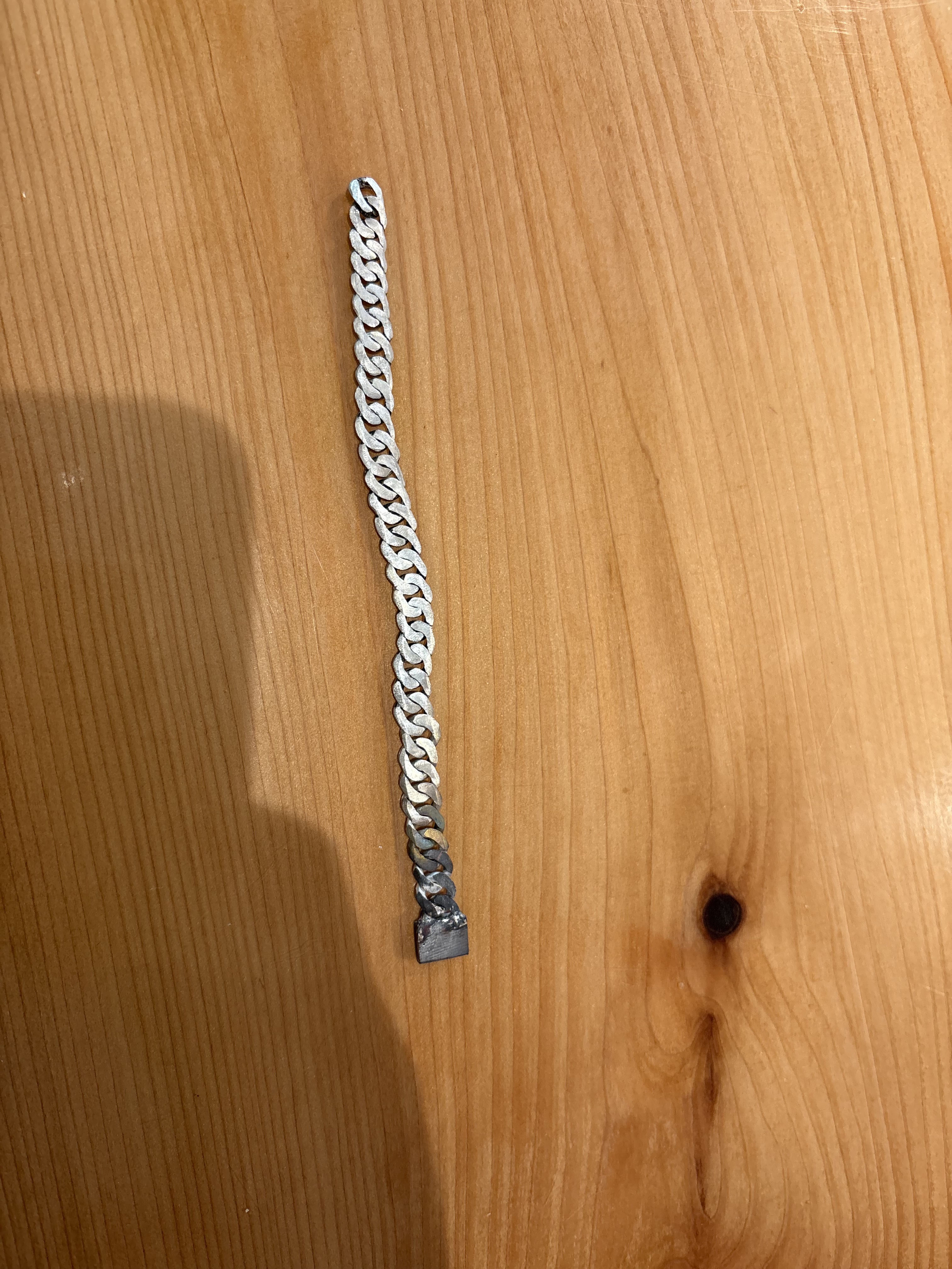

Looking for advice and constructive feedback on my chain and how to improve. Seems like I can’t nail the Miami Cuban style just right, so I wonder what I could be doing wrong potentially, or what I might need to re-evaluate. Not sure if it’s an issue in my twisting, or if maybe I need to file even more. Looking for some advice from others!

i am just pondering…it looks a bit “loose”…?
perhaps thicker guage wire links, and/or smaller diameter links…?
so there is less space between the links…?
i kinda prefer the look of cuban link chains that a filed a bit rounded, as opposed to flat…
just my two-cents
julie
I might try decreasing the aspect ratio on the rings on the next go around. Thank you!
