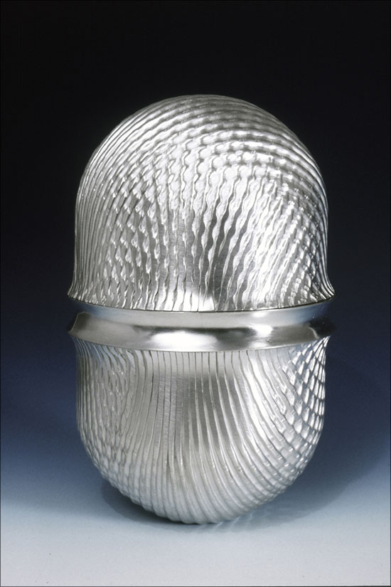

Convergences II - Holding Place
Materials: Argentium Sterling Silver
Dimensions: 4" tall, 2.5" diameter
I am fascinated by the way that metal that has been textured and/or patterned changes when the metal is formed by deep-drawing in a hydraulic press. This vessel is one of a series exploring the patterns created by deep-drawing microfolded (corrugated) metal. I am entranced by the way the folds pull together elegantly—hence the title for this series: “Convergences”.
Process:
-Sterling silver sheet was microfolded (corrugated) in a microfold brake. After annealing, it was microfolded again, at an angle to the first direction.
-Each sheet was sawn into a circle.
-Each circle was deep drawn in a hydraulic press to make cylindrical forms.
-The forms were trued and gently flared with mallets and steel stakes.
-The center section was formed (anticlasted) with hammers, mallets, and stakes. The rim was carefully formed and fitted. Soldering these to the textured vessel was tricky—getting the alignment right, and making sure that the solder did not fill the texture were exacting procedures.
-The sterling silver is a new alloy containing germanium, which is called Argentium Sterling. The germanium replaces some of the usual copper. This gives the metal tarnish resistance as well as fire scale resistance.
