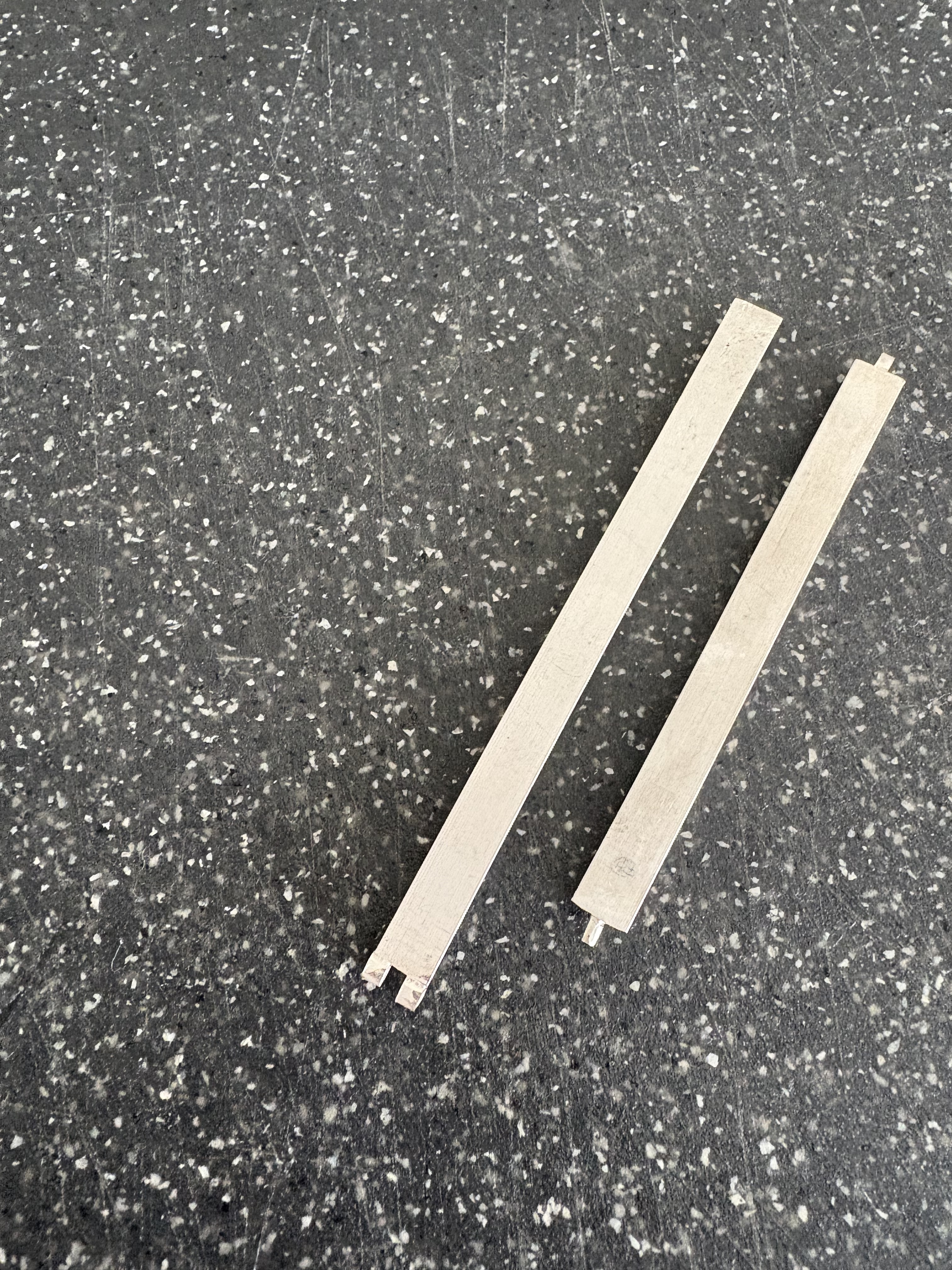

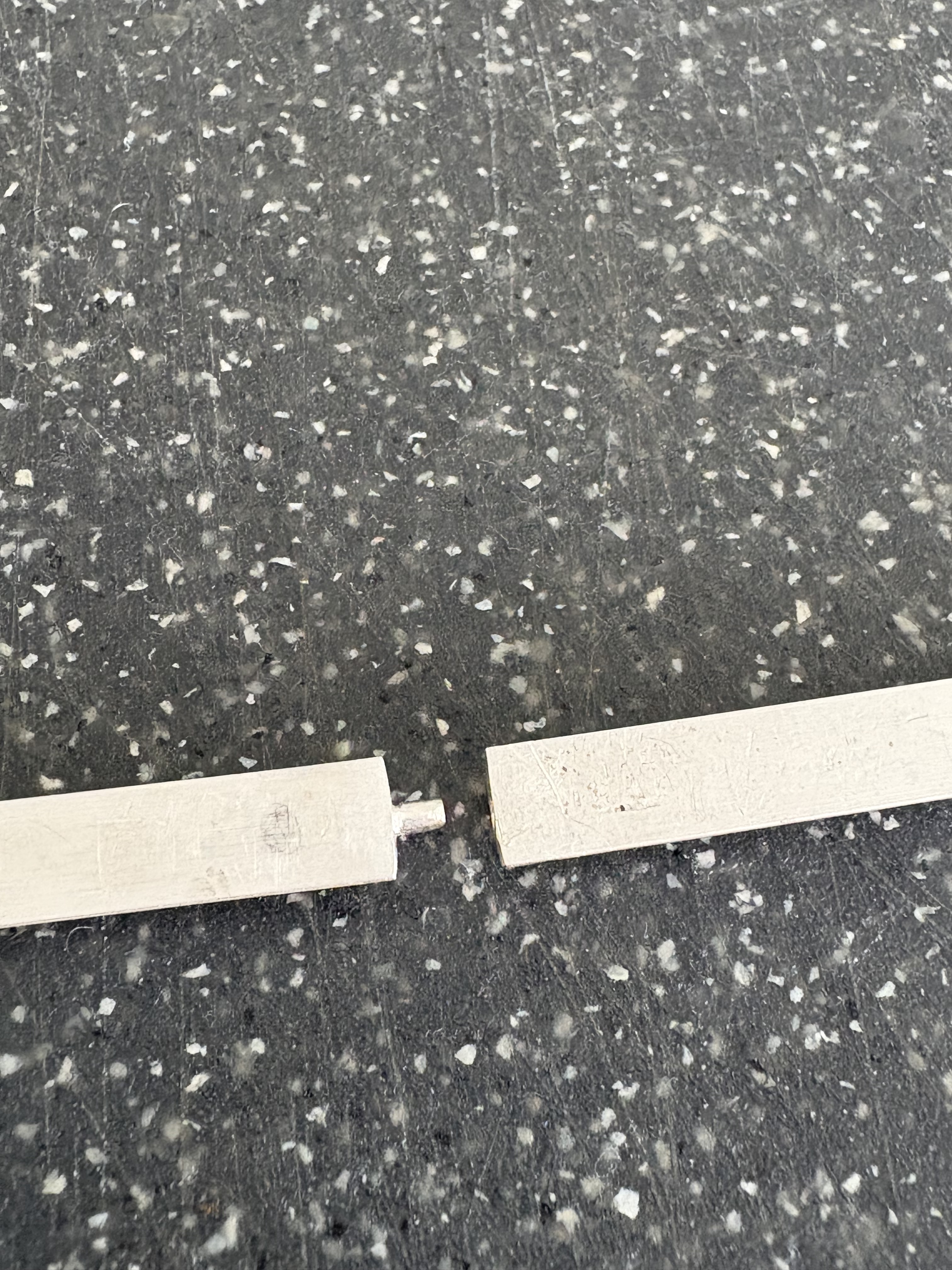

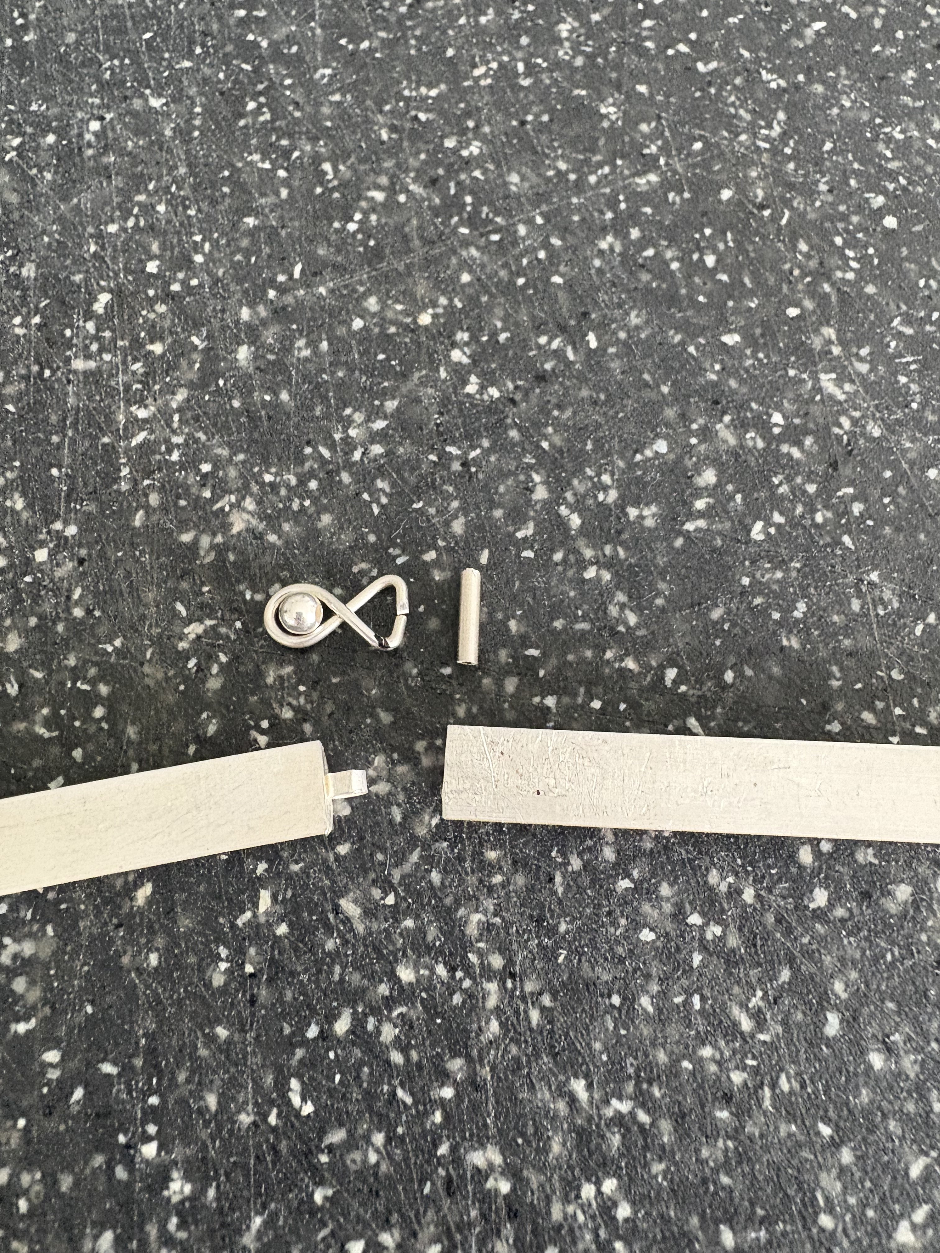

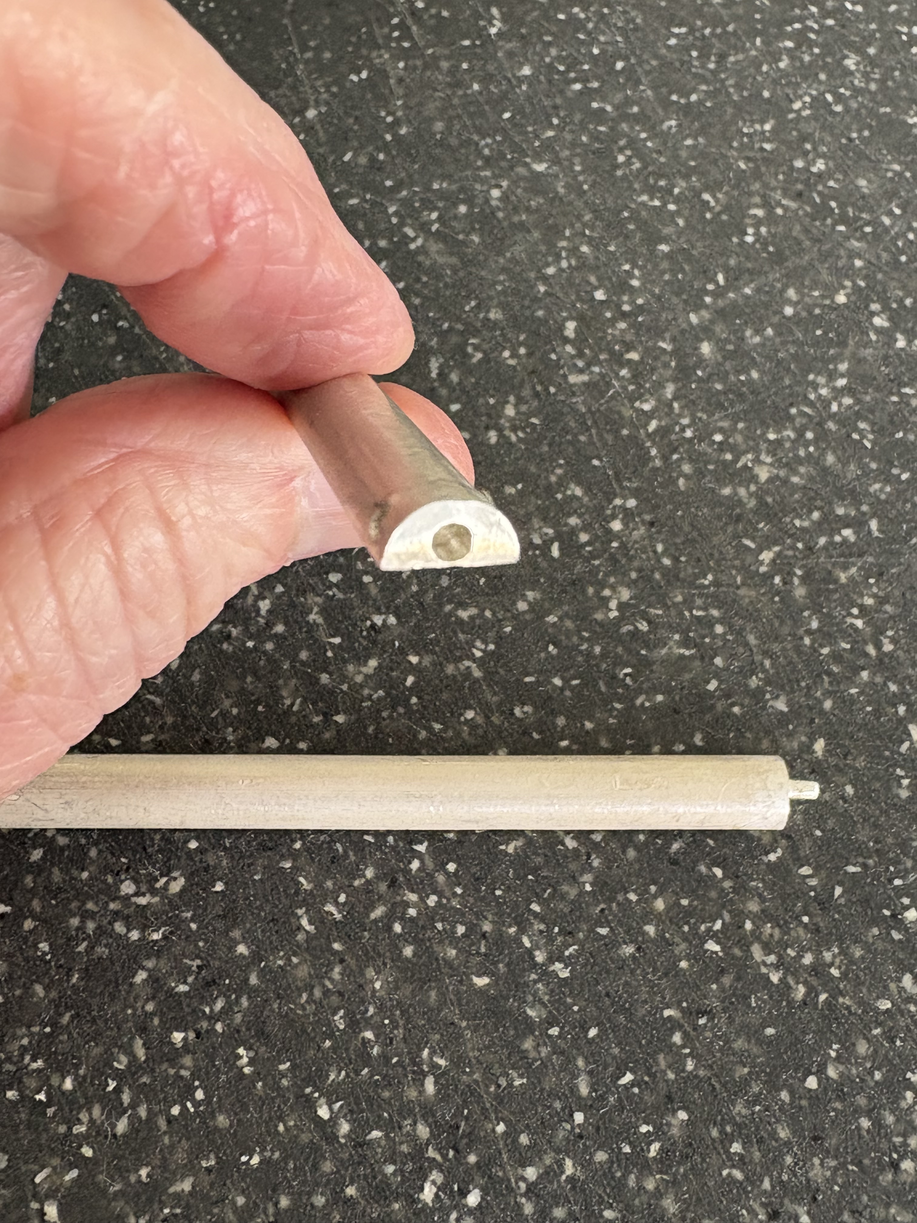

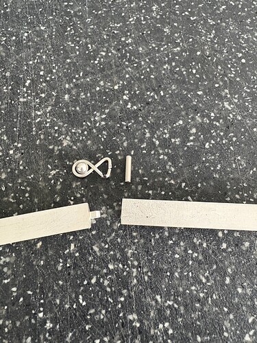

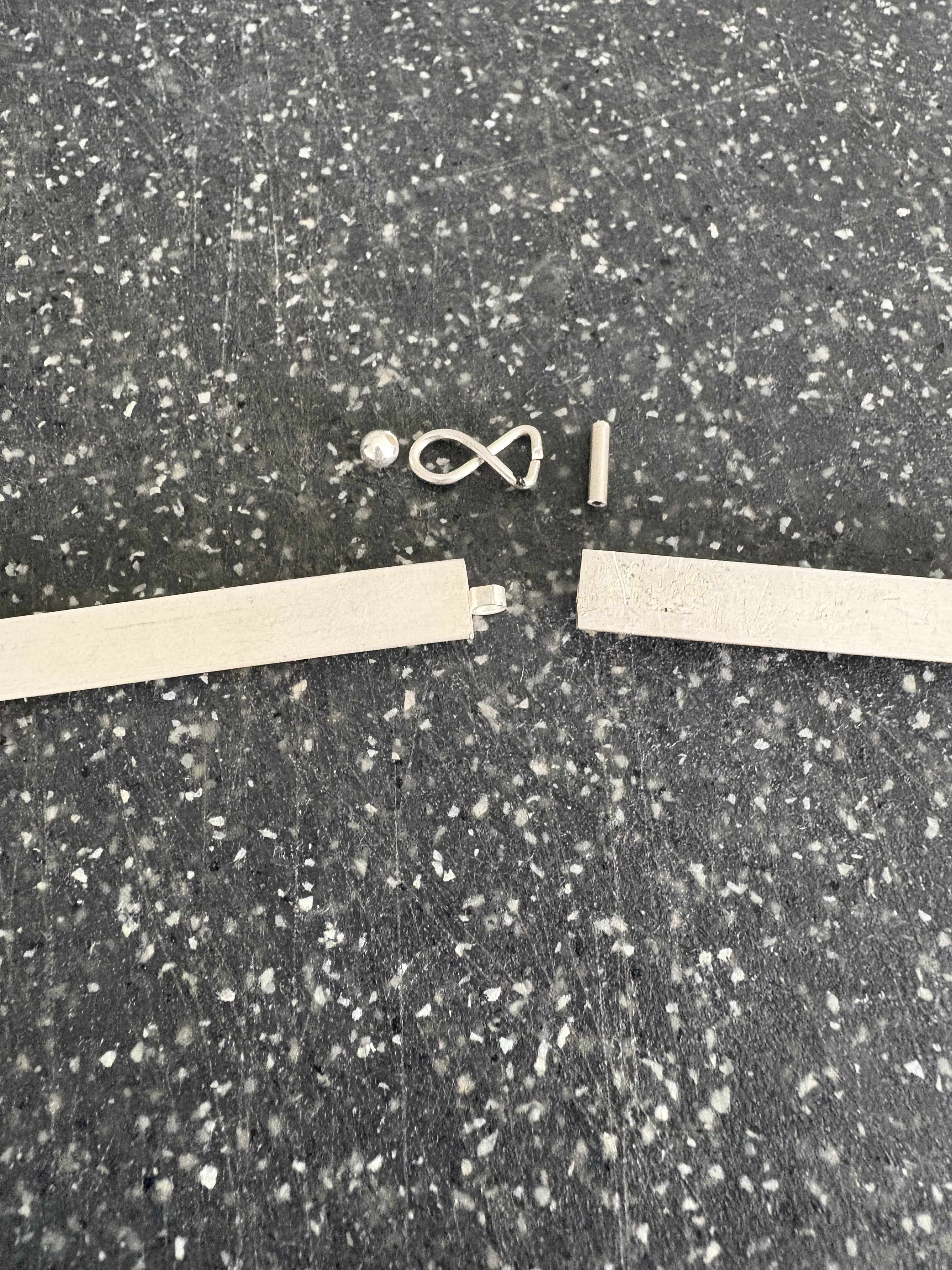

Photos of bangle not shaped yet . Outer side is flat side . .
Thank you for your response. I don’t think the examples in the link will work with the shaped wire but any thoughts would be great. Thank you
After seeing your photos I have a couple of words of advice.
A: When making a hinge it’s really important to make sure that the center part is at least twice the width of the two outer parts. Slender equal widths aways eventually loosen and are not very stable.
B: As for clasps Buy Tim McCreight’s book The Complete Metalsmith: Professional Edition. You can buy used copies all over the internet. It’s a great book.
Thank you for your advice I appreciate that. Think maybe I’ll change the hinge and do it as you suggest , better to get it right now before I do anything else .
I have the complete metalsmith , but not the professional issue so I will look for that also.
