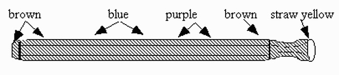

i have found that when commercial chasing tools are offered for
sale, they still need finishing work. the edges are always to rough
and not smooth.
and commercial stamping tools are usually not very well made either.
i have had to file the imprints down to sharpen the stamping
capability and then re-harden and temper. i have found that these
tools bought commerically are not even properly hardened and
temerped in the 1st place!
therefore, i find it best to make my own stamps and chasing tools.
